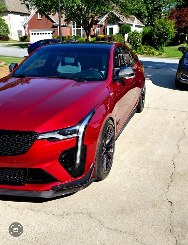

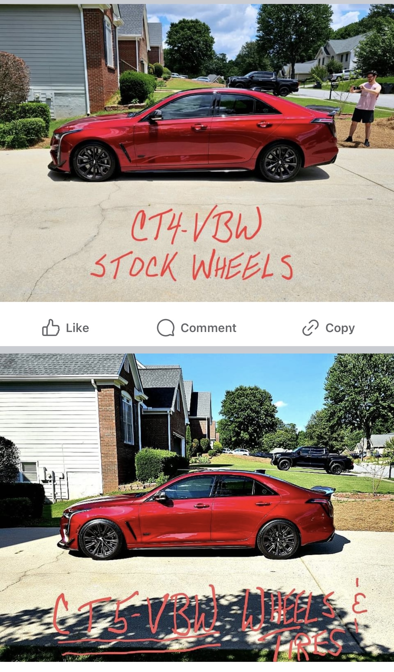

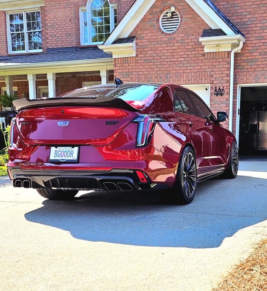

Fronts look super tight but it looks like he's lowered. Too bad he doesn't have shots from the front or back.
Stock 5BW wheels (19x10 +20 and 19x11 +50) are perfect specs for the 4BW. The only thing is you cant use the stock front tires. They're too tall of a series and would need to go from 275/35-19 to 275/30-19s. Rears are perfect and same stock overall diameters as the stock 4BW wheels.
