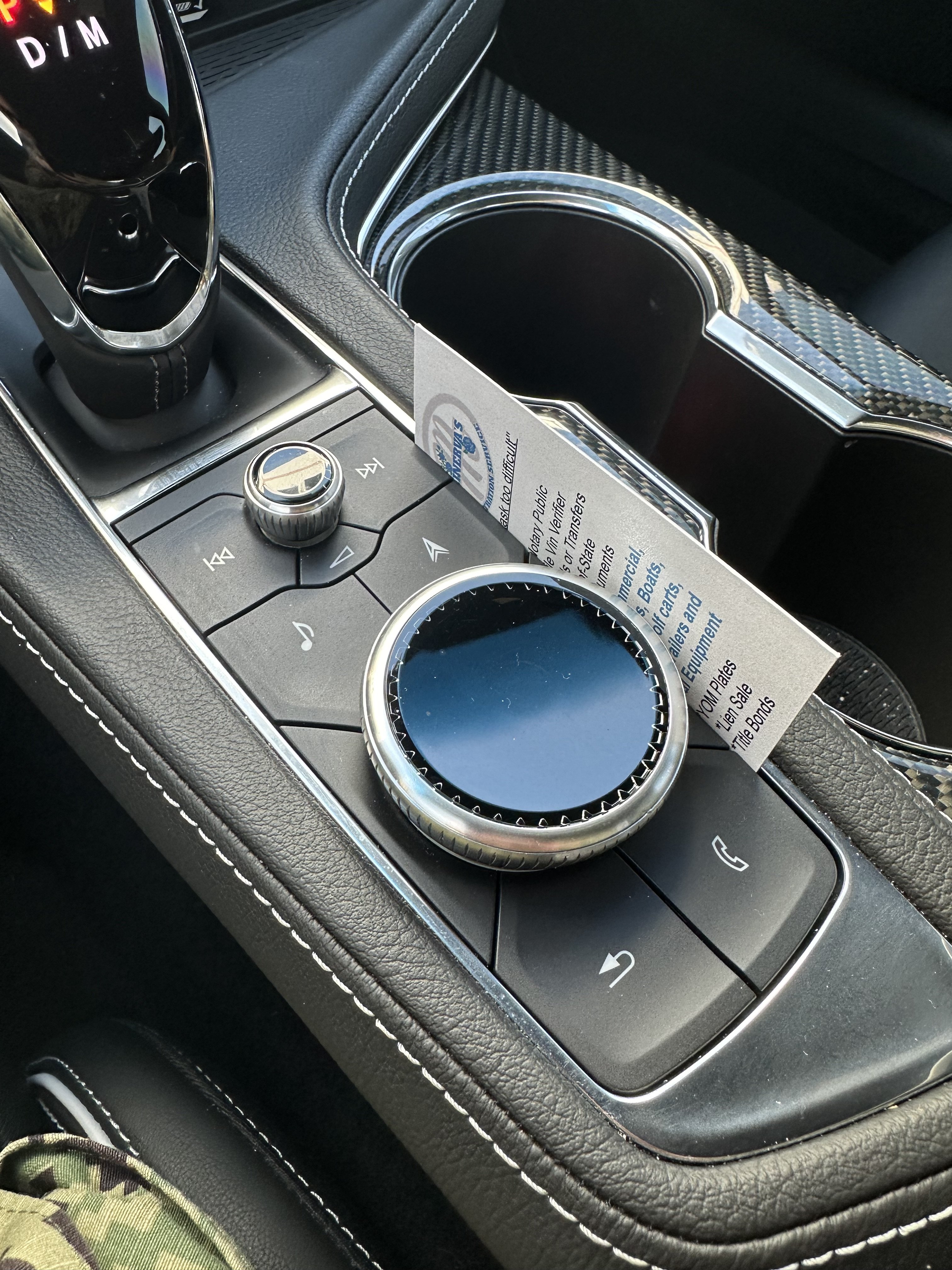

So the only rattle that came with my slightly used 2023 was in the center console. Luckily I found it pretty quickly unlike some and identified a fix. The whole CUE control module vibrates side to side at some frequencies from the engine. A business card inserted in the gap fixes it, so I am going to cut some black construction paper to fit just so and call it a day. (Looked up how to remove the center console and decided nah...)
Was wondering if anyone else had the same issue. Could take it in under warranty but not a big deal and happy to not have to get behind the dash.

I have a 2023 CT-5 V in exact same color and have a similar rattle. I'll have to shove a business card in there and see if it eliminates it.
