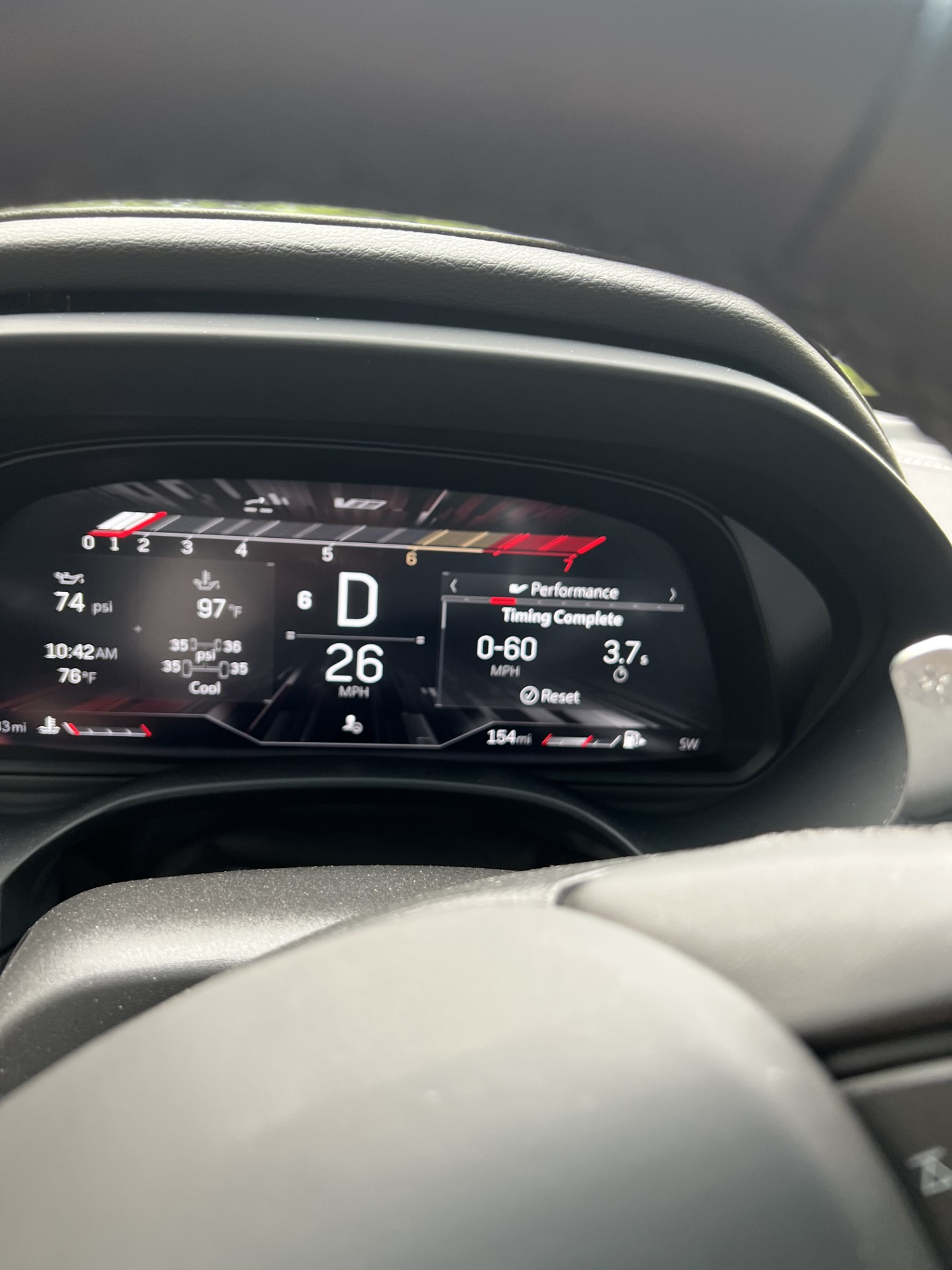

^^this is my overall best 0-60 time so far -- this one was on all season tires, @ 70*F, using custom settings with RPMs set higher than auto had them at launch.
My best times on the OEM summer tire are a back to back 3.8 & 3.9sec 0-60 on a newly paved road. The first few were trash, so I played around with the custom settings until the times started dropping significantly. I will disclose that most of my other 0-60 times are nowhere close to these. These tires are more finnicky in my personal experience, but they do hook significantly better from a dig when slightly deflated (I use ~30psi for 0-60 runs in just the rear tires).

What were your rpm and % slip settings?
track mode with PTM on race 2 - no manual shifting with paddles
IIRC
slip target 12%
1600RPM - reduce if you are losing traction from a dig
