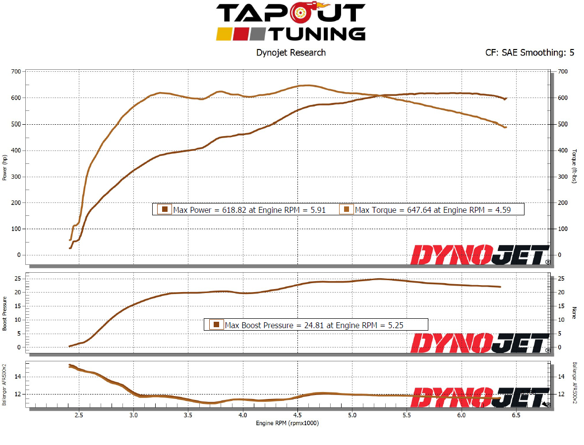

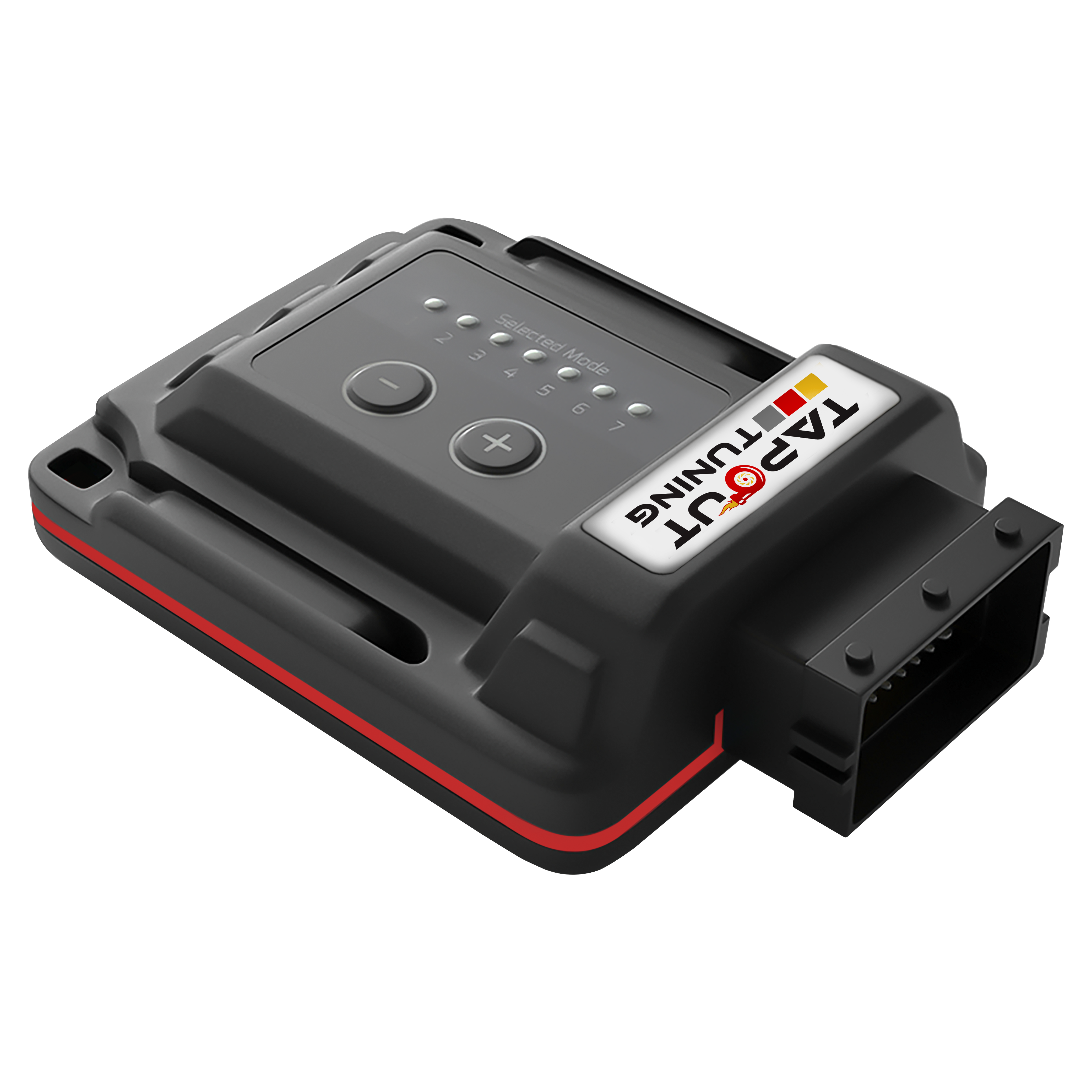

Using our soon to be released Tapout Tuning module, we are able to produce a much smoother powerband than any other tuning device for these cars. Seven different calibration maps are stored, and can easily be switched on the fly in just a few seconds using the no charge cell phone app. Here were the final results for this car:
  • OEM baseline = 426 whp on 93-octane
  • P1 = 445 whp on 93-octane
  • P2 = 500 whp on 93-octane
  • P3 = 510 whp on 93-octane
  • P4 = 520 whp on 93-octane
  • P5 = 584 whp on 93-octane with methanol injection
  • P6 = 599 whp on 93-octane with methanol injection
  • P7 = 619 whp on 93-octane with methanol injection
Kaylee and Jonathan now have the most powerful CT4-V Blackwing in the world, except for our flagship car.

When are you releasing the tuning module? Spring's coming and I have an itch..
Can the tuning module be used by itself and installed away from the shop or do y’all have to tune it on a dyno?
These are available now for local installations with custom tuning. At some point in the future, once we accumulate enough data points, we will start offering these tuning modules for shipment.
At this time, we are only offering these tuning modules for local installations with custom tuning. At some point in the future, once we accumulate enough data points, we will start offering them for shipment.

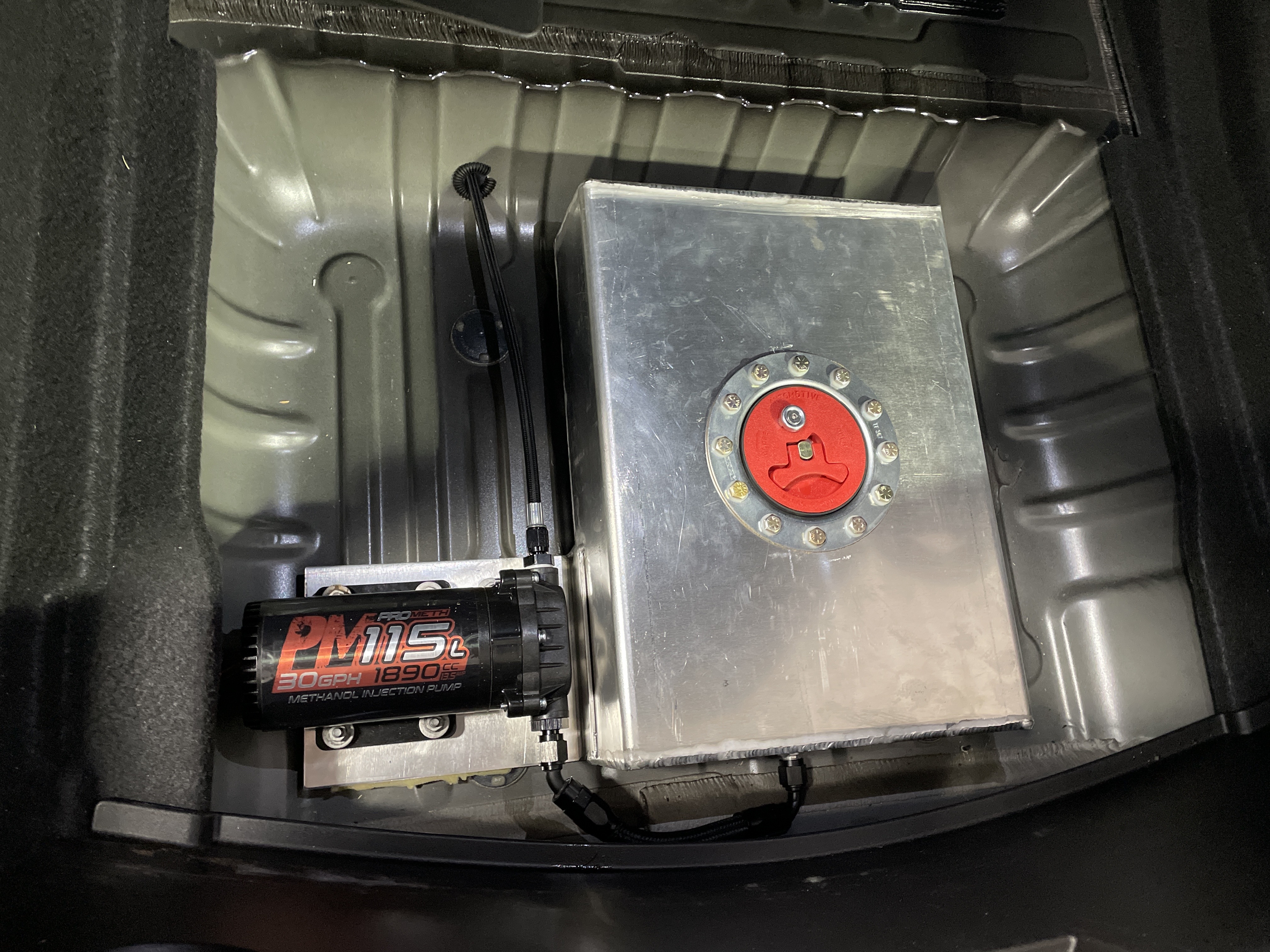

Whose meth injection kit do they use or is it all through the new module? I used an aem controller and pro meth pump and nozzles with the setup on my mustang and was pretty happy with it.
Its a prometh kit with a snow controller. Custom tank in the trunk and nozzles going into the intake pipes on each side. I have been really happy with it! Very clean install, no issues, easy to change settings, monitor boost, and refill when needed.

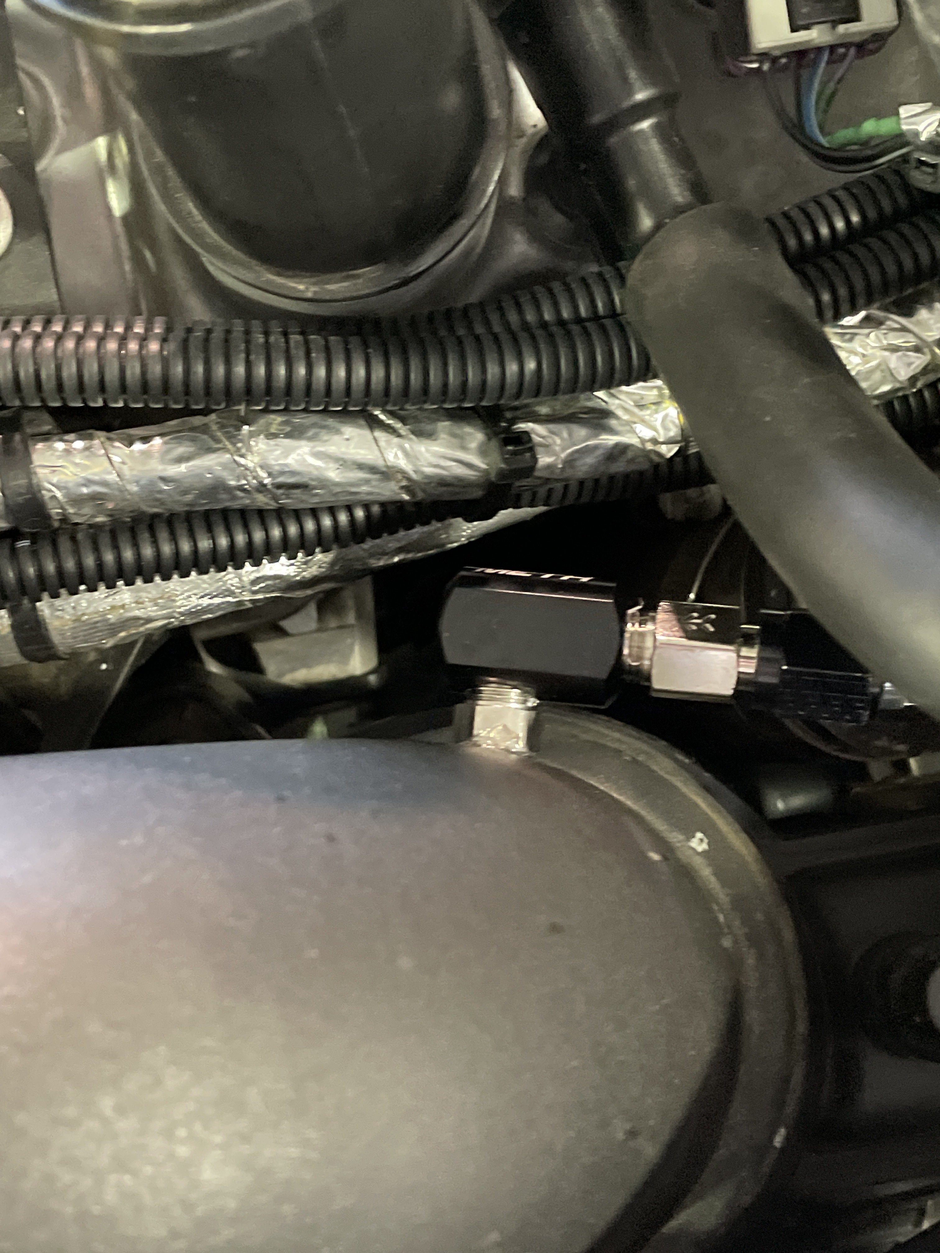

Yeah that all looks familiar. Lol. Any shots of the nozzles under the hood? Also are you running water/meth mix or straight meth? I played around but it made more power straight meth so I only threw water in on the street for dd
This is the only one I have handy. Driver side nozzle.
