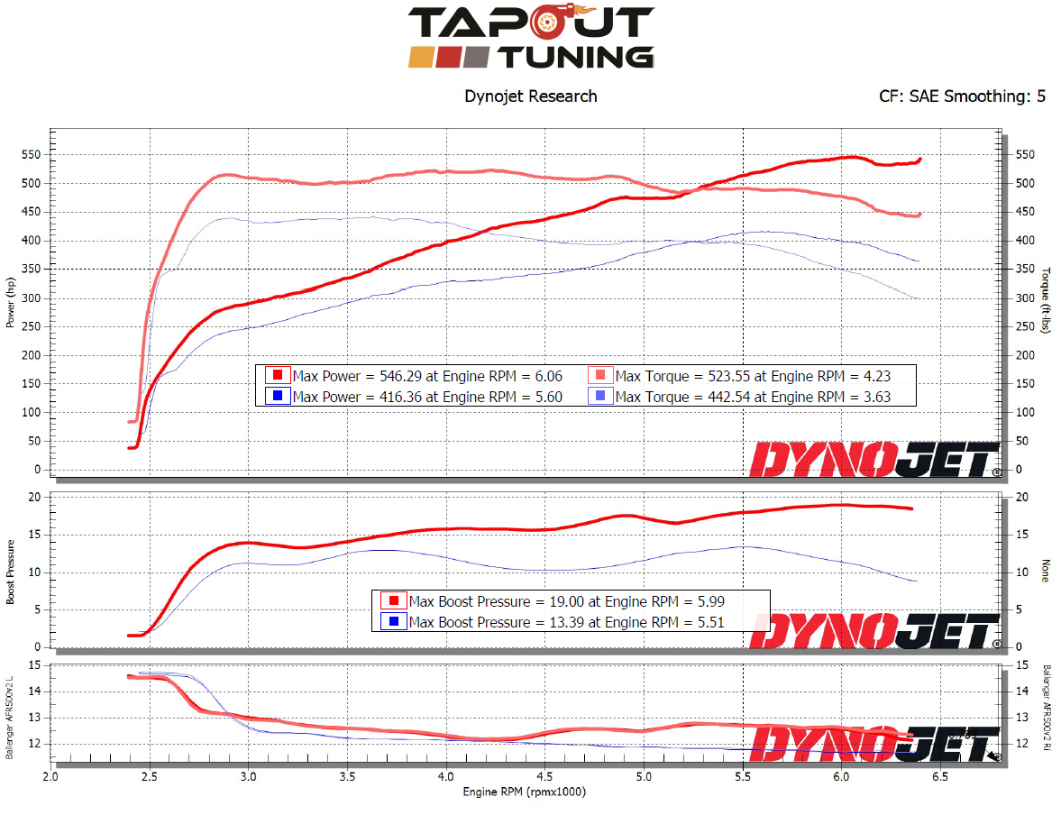

Charley had a good friend drive his car up from Florida to our shop in Ohio for the Blue Belt Performance Package. After installing Green high performance air filters, Gigs ported throttle body, Brisk silver racing spark plugs and Tapout resonated downpipes, we strapped the car to our DynoJet and got to work on the tuning. Peak power increased from 416 to 546 whp, with more power at every single point across the rpm range. Multiple 546 whp pulls were done back to back using E30 fuel and a custom calibration map that we created in house. We also provided a 93-octane map in case he isn’t able to locate an E85 station on his 1,118 mile trip back home.
Our team has worked tirelessly to create and develop the best possible performance parts, tuning and complete performance packages for the CT4-V Blackwing cars. We’ve made some incredible progress for a car that was originally thought to be ‘completely untunable’. Since August 2021, Tapout Tuning has been the innovator and always led the charge in this platform. Stay tuned, because there is more to come…

Ethanol fuel blend tunes tend to approach the limits of the stock CT4-V Blackwing fuel system capacity. That's why we were conservative and stopped at 546 whp. It would be no problem to turn it up a little more. Tapout Tuning has an excellent reputation to protect, so all our custom tunes include a reasonable safety margin.
For those of you running gasoline with no ethanol, you can turn up the boost even more before you reach the fuel system limits. So 600 whp should be within reach when you add octane boost to the equation.

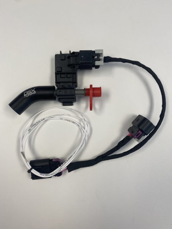

@strohw Thanks, that makes sense. Is there a sensor/kit currently available for the 4BW? I looked a bit online and didn't see anything. Or are people just using one adopted from the ATS-V?
The sensors themselves are all universal. the atsv kit would get really close but likely would need a little custom love to work on the bw. nothing a shop doing the install couldn't do though.
We worked with DSX Tuning to develop an alcohol content sensor kit that fits ATS-Vs perfectly. However, it send a frequency output that works fine with E92/A ECMs. The E99 ECM in our cars has no alcohol content sensor input provision. In addition, there is no way to program the ECMs to enable flex fuel anyways. So what I'm saying is there is no point in purchasing the flex fuel kit, since it can't actually be used on our Blackwings.
