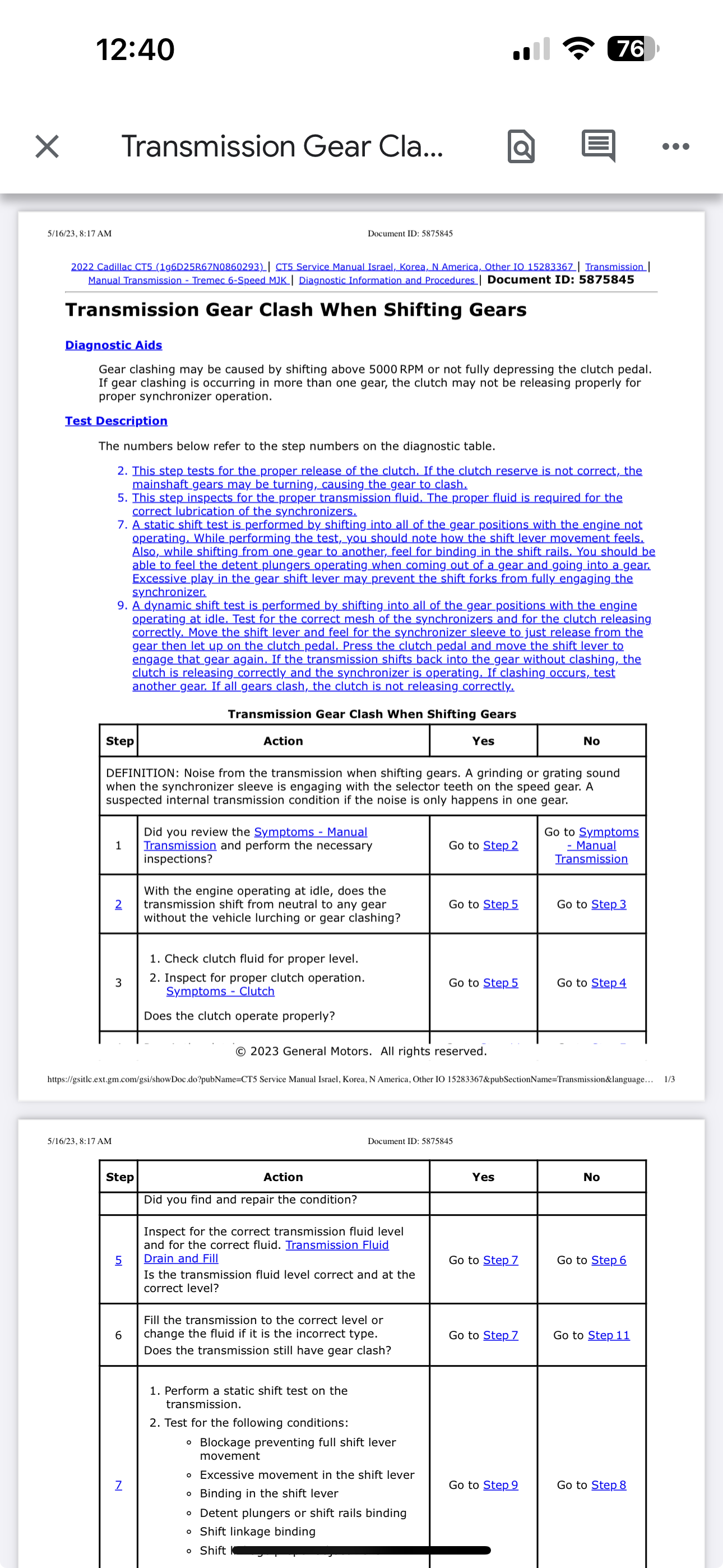

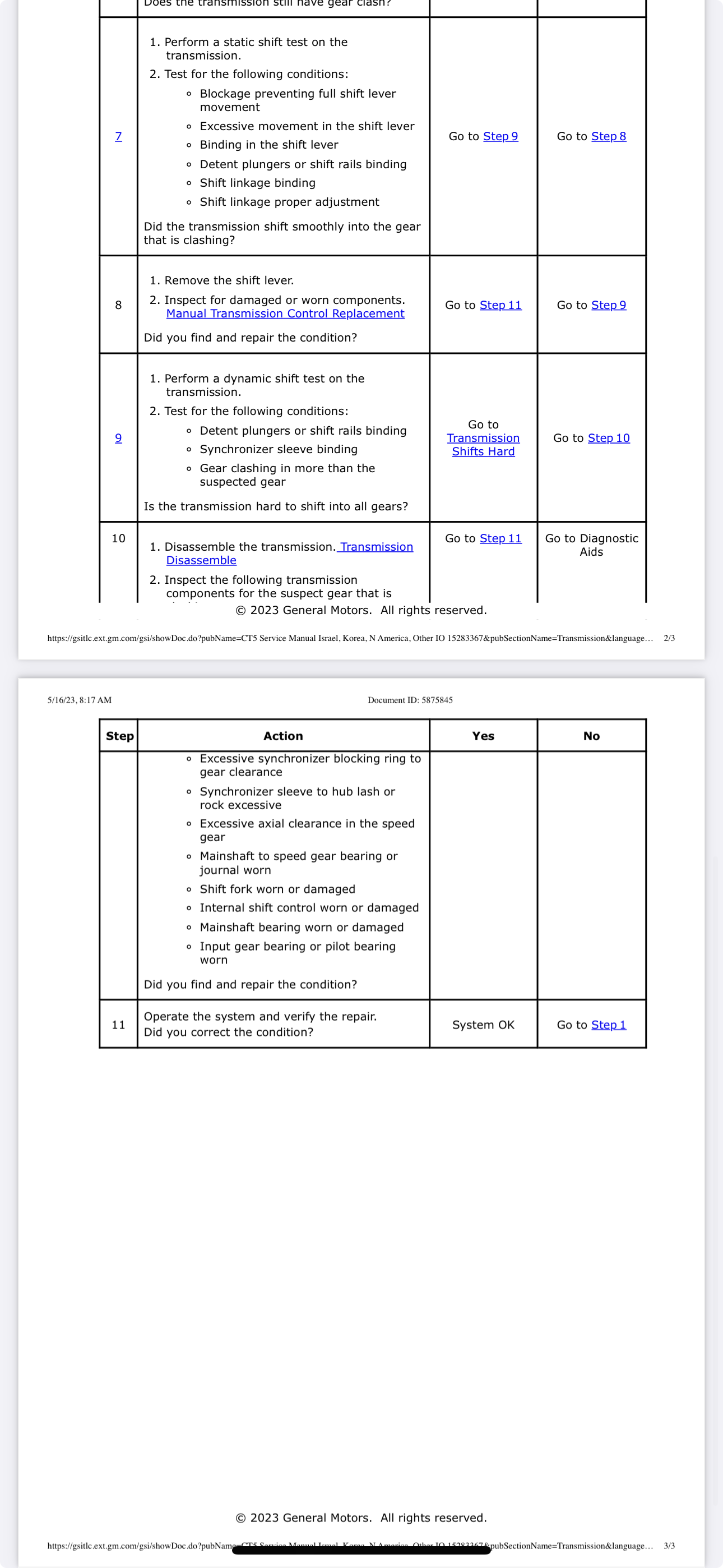

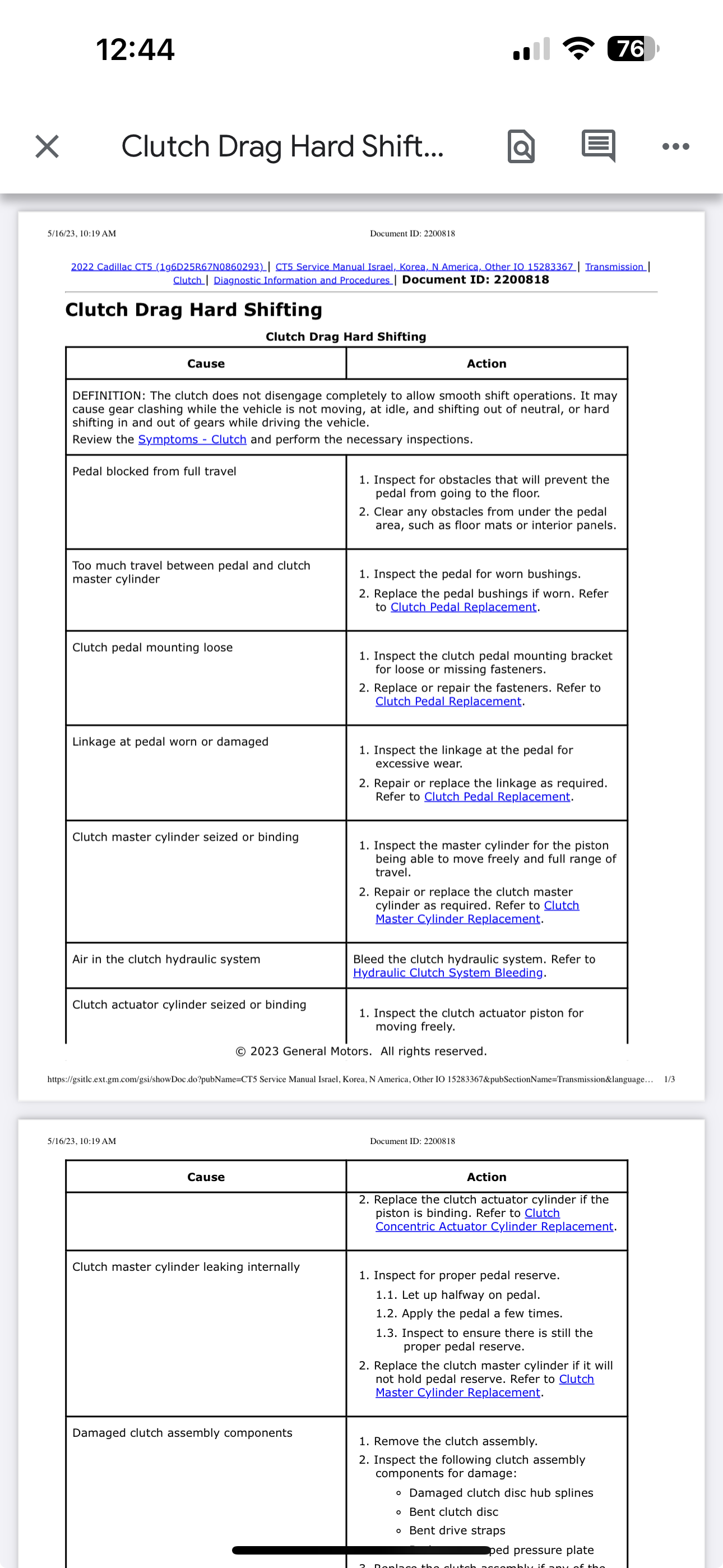

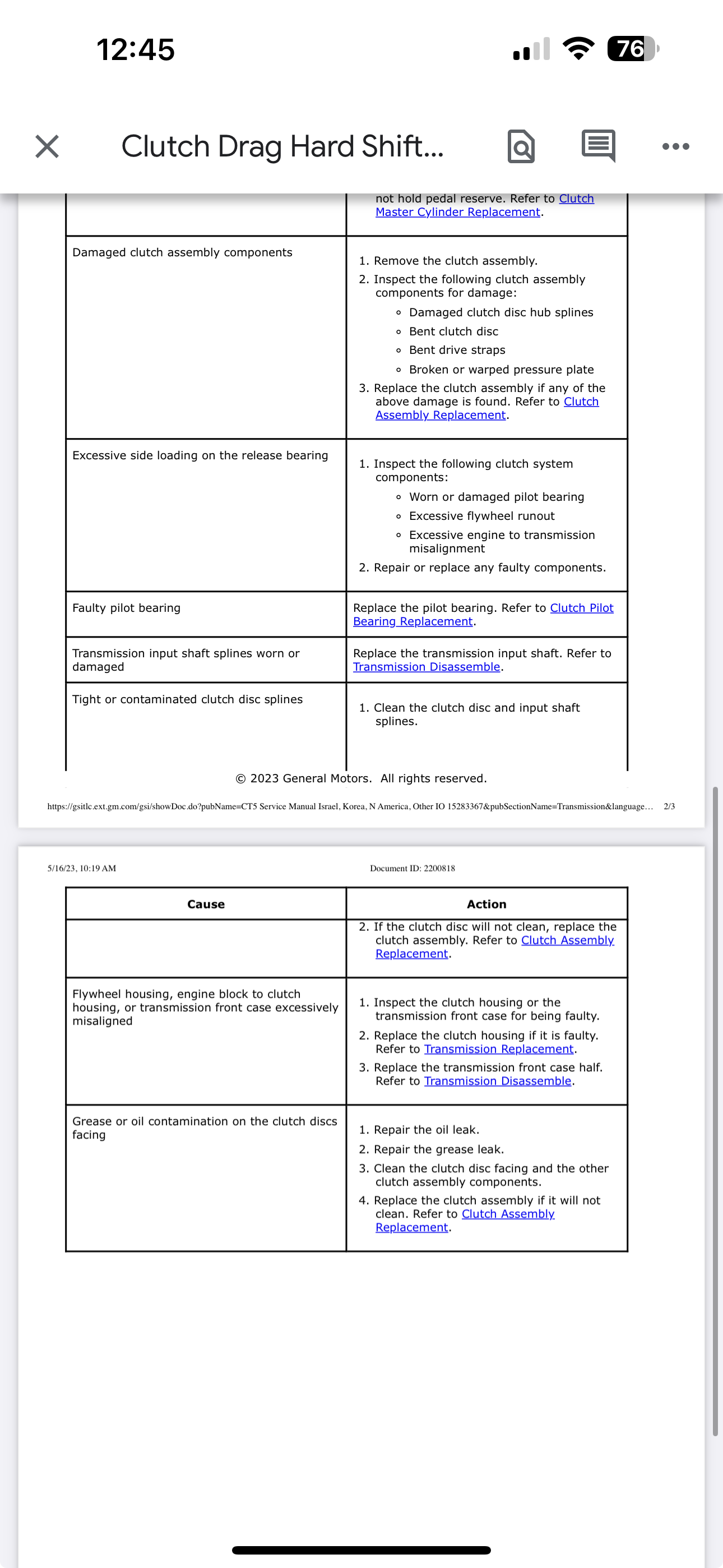

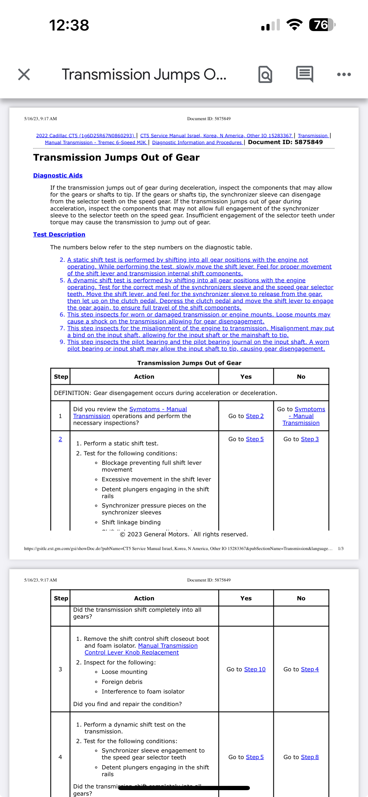

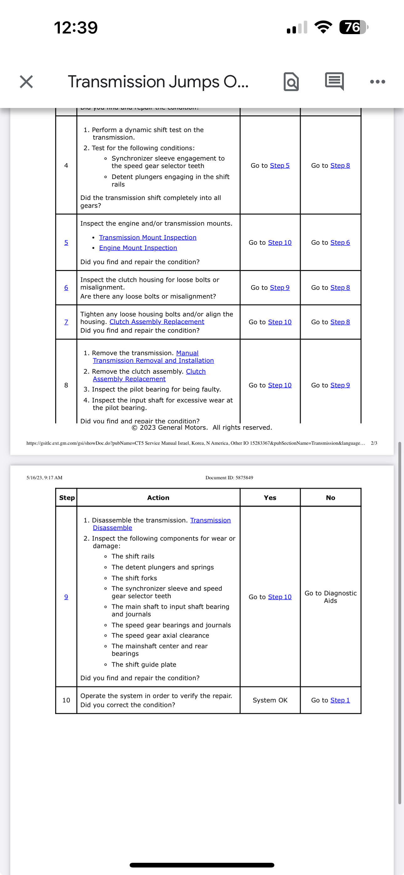

I really think if the trans/clutch are this troublesome it will need to come down for a physical inspection of the clutch/flywheel/transmission. Here’s some service documentation which maybe helpful but most of which you’ll need to have a shop perform (I’m speculating, no offense).
