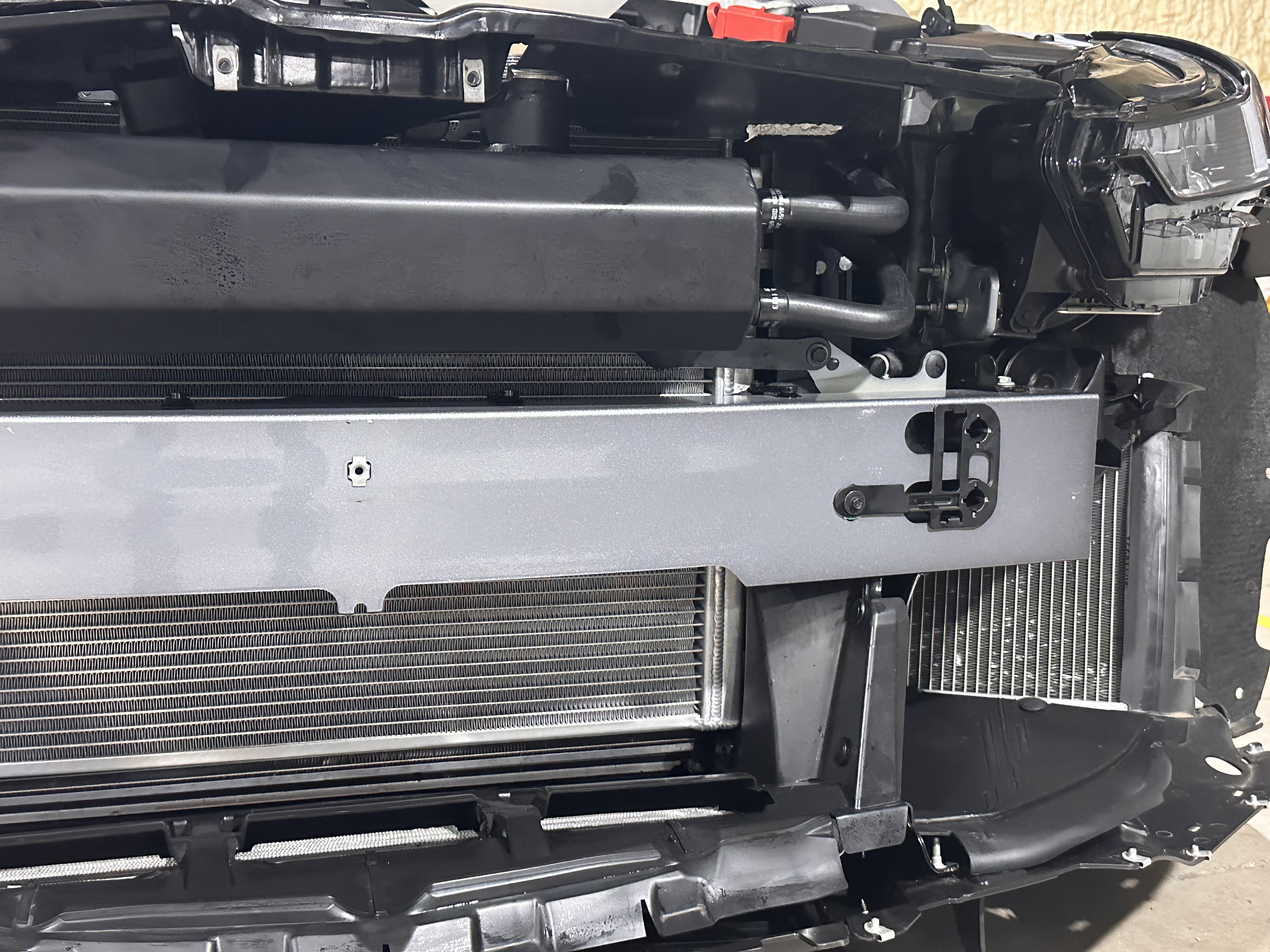

I have heat exchanger and expansion tank. Yes massive difference.
Assuming the bricks make a difference as well may try those next week.
During my test fit process.
For 6sp guys, I can see the benefits when doing 4th, 5th, 6th gear pulls. The car actually goes through 6th with little effort. Mid 120s Iats on 200mph runs.

I plan on doing the heat exchanger and expansion tank over winter.

I ordered both from LMP I will report back when finished
Lmk if you have any issues. They text me some videos. But left a lot to the imagination.
