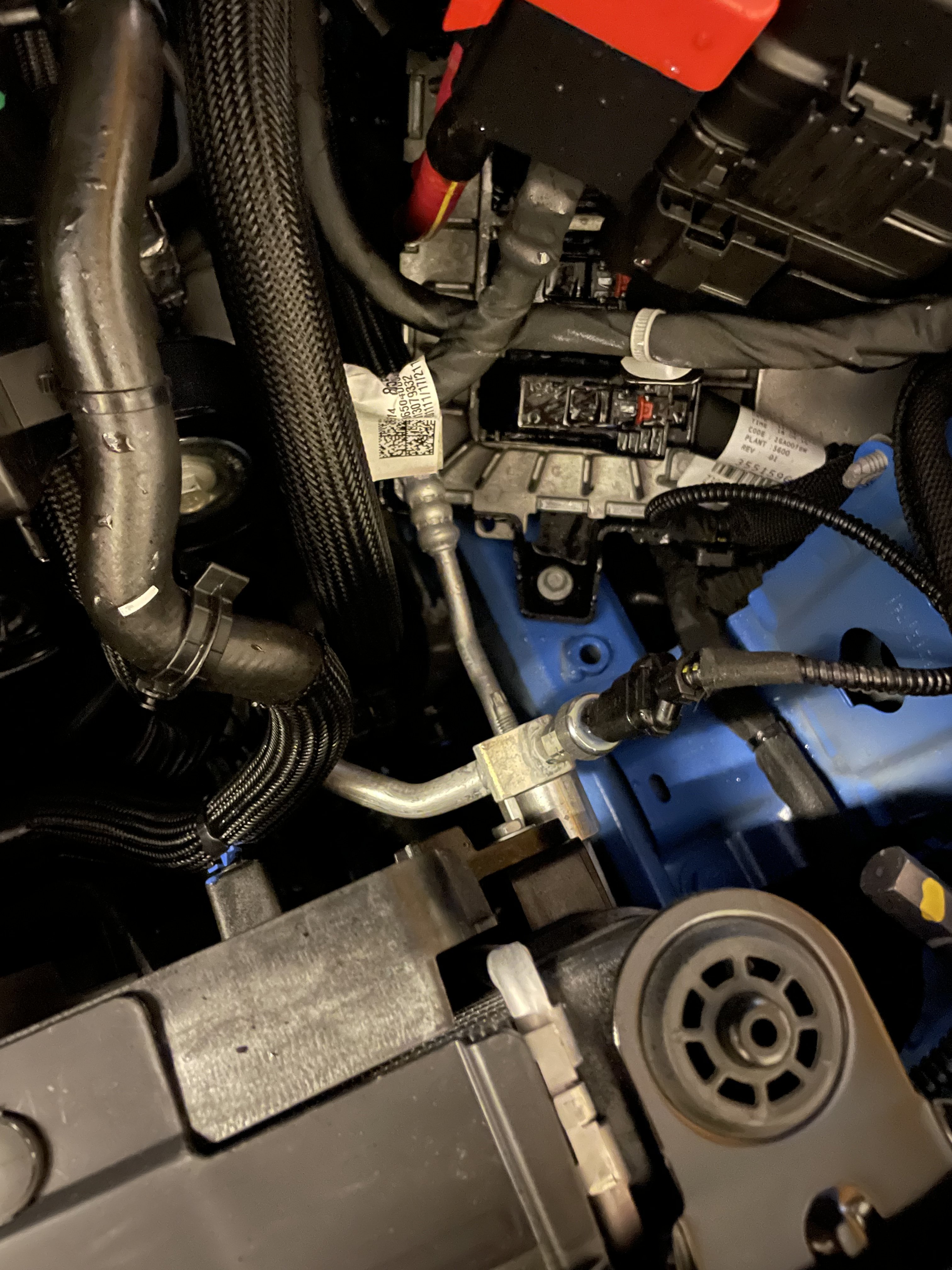

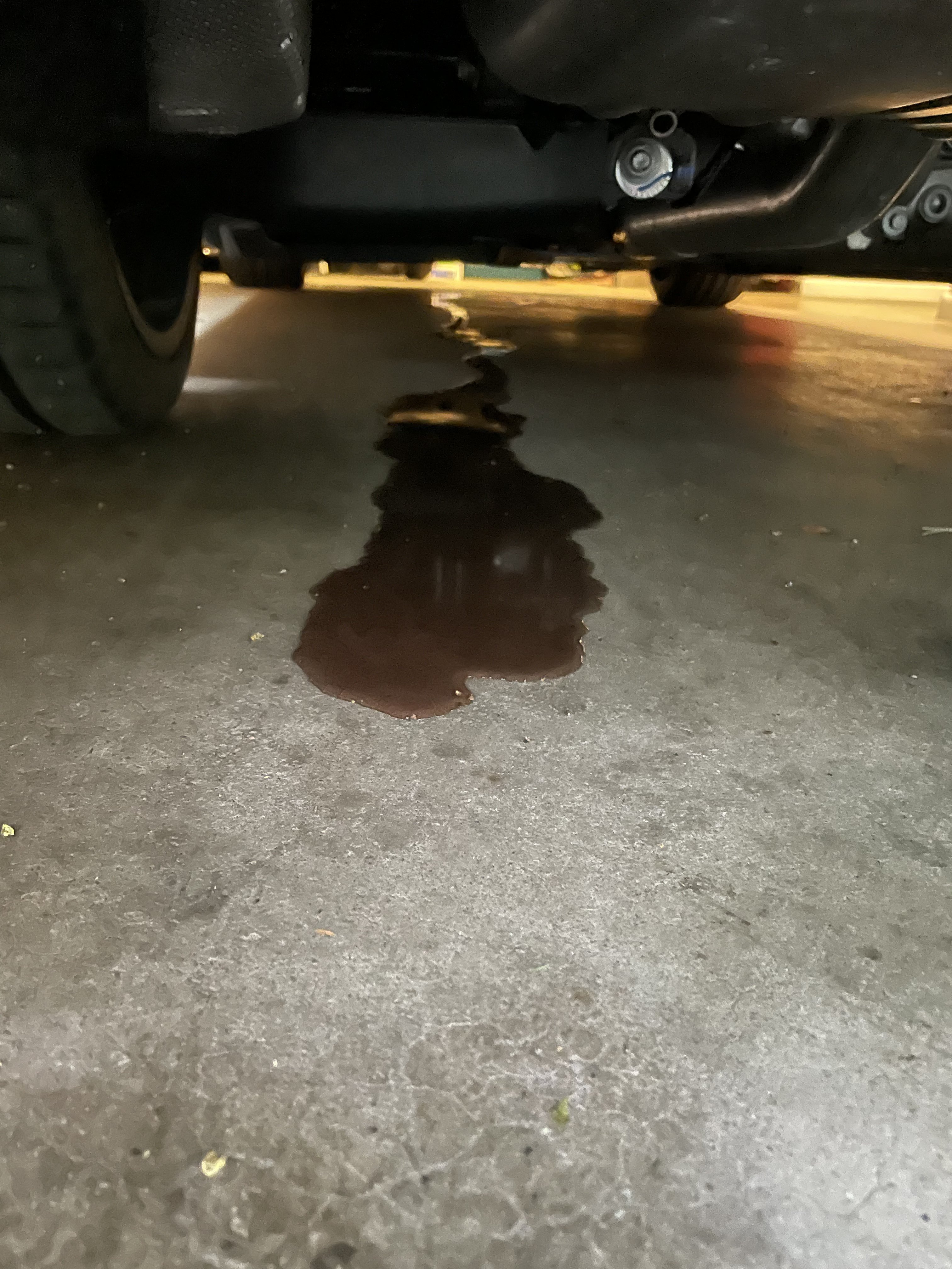

Pulled in the garage and smelled coolant and saw some smoke/steam coming from the hood. Opened it up to see coolant in the engine bay and dripping underneath the car. It wasn’t immediately clear where the leak originated. I know how much cooling there is on this car and I imagine a hose clamp came loose somewhere. Now the question is do I try to drive it to the dealer or proactively tow. Anyone else experience similar?

I’d say have it towed. Insurance or even the car’s warranty should cover the cost. Not worth the risk of driving it.
Oh boy. I am no expert, but if that were my car, its next move would be onto a flatbed. Good luck, I imagine the repair is easy, but the hassle is never fun.

Thanks for the feedback. I plan to do a bit more troubleshooting to try to find the source of the leak. Strange because the expansion tank still has visible coolant in it.

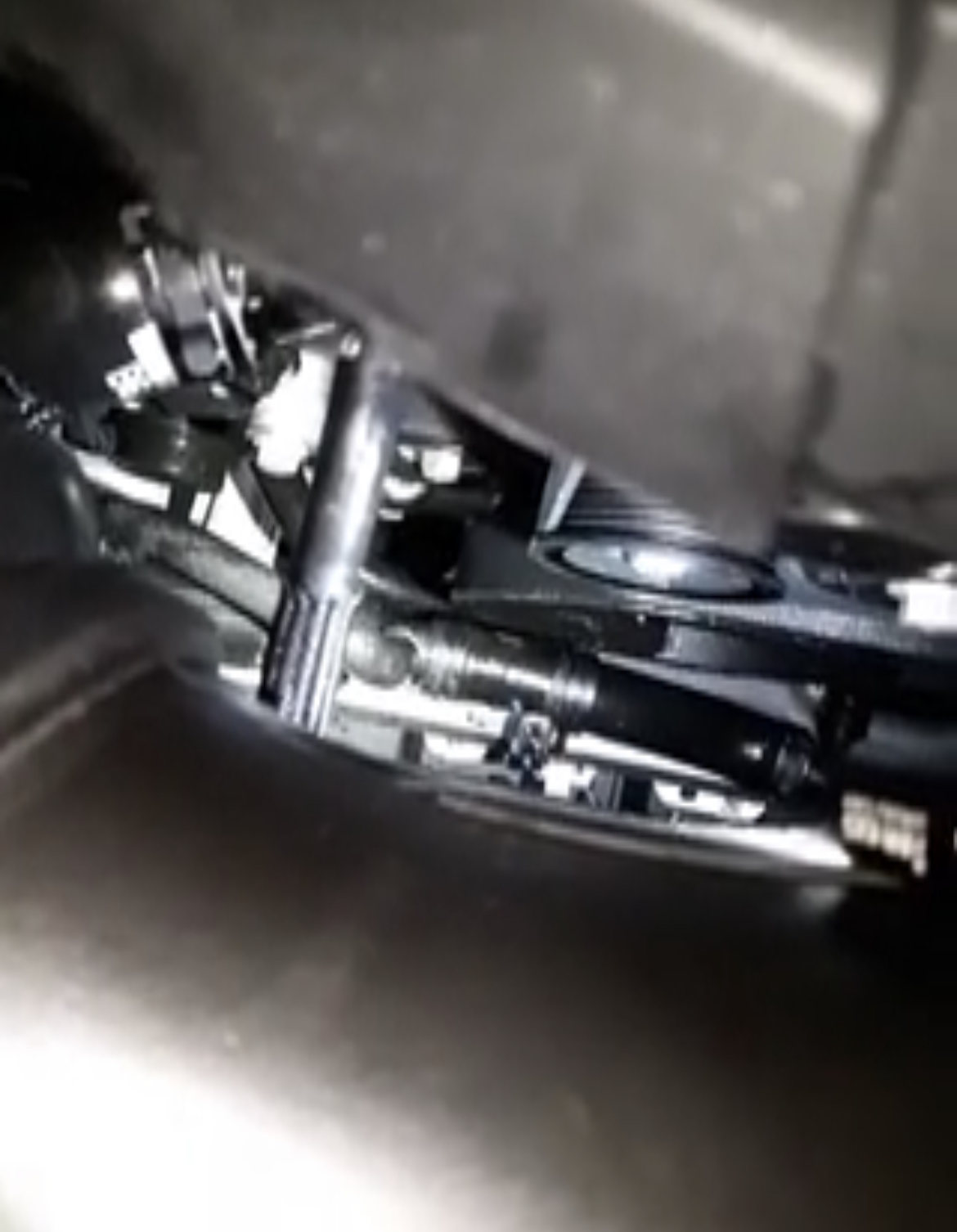

Problem figured out! There is coolant plumbing/hoses right next to the lower pulley. Apparently it was not seated correctly and was making contact with the pulley and eventually wore through the hose. Seems like bad QC at the factory. Dealer indicated new hose should arrive tomorrow. Frustrating but at least it will all be resolved tomorrow. Next step will be trying to clean all the coolant out of the engine bay...ugh.

A little bit difficult, but possible to inspect. I took a still from the slick video the tech sent me explaining the issue. Hopefully this helps.
