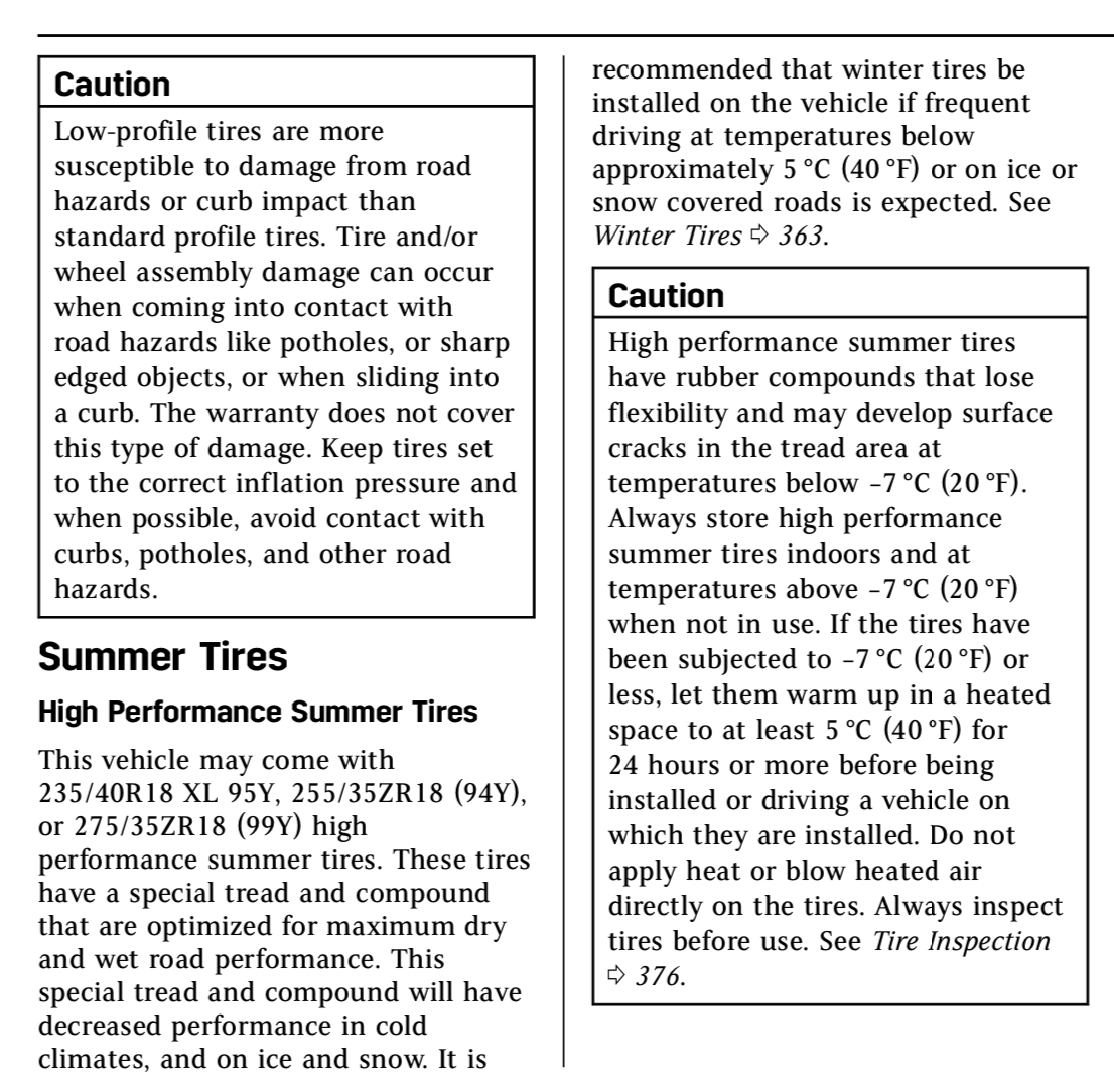

Roadhawk and I are in the same neighborhood, and he's correct about his assessment. My car came from texas with summer pilots. I found out early on when I purchased it in January sub 30's, hard asphalt, I might as well have been on ice skates. It was lost on me initially that the tread pattern and rubber compound, was not conducive to cold asphalt roads, and I wound up purchasing some Mich pilot sport all season. Been very happy with them so far. Next year, I have to buy new summer rubber and I'm looking at the Continental ExtremeContact Sport 02 to go on my Aerrolarie's. I was just never really impressed with the summer pilots...., but to be fair, they did have 10,000 miles of what looks to be hard driving on them when I received the car. I did learn something new here recently about the summer tires from the owner's manual of all places. I learned I can no longer keep them out in my unheated shed when storing them for winter.
I think this is more of a CYA on GM's part. I've had summer only tires on three GM vehicles that were stored for the winter here in Ohio. Now granted, the tires were on the car but as long as you don't drive on them below 30 degrees, the tires have been fine with no cracking. I can't see where not being inflated and on the car would make a difference.
It's just common sense to warm them up before installing them back on the wheel. That I get.
When I lived in Ohio, my Chevy SS would sit in the garage through the winter with the summer tires still on the car. I never had an issue with cracking, but it didn't get driven when it was below 40 degrees outside. I only drove the car one time in really cold weather -- the alternator died in my daily and I had to drive the SS to the parts store when the temperature was in the teens. The roads were clean and dry but I might as well have been driving on ice. Traction was non existent to the point where I spun the tires for about a hundred feet just trying to pull away from an uphill traffic light. I let the clutch out at idle and the tires just started spinning, lol.
