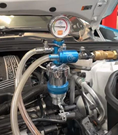

My favorite bleeder out of the 4 I have hooks to the factory port and has a quick disconnect and long tube.
The others didn't work as well. Lastly I tried jumping the fuse, but I could never get it to work. Ended up getting the motor warm to the pump would start and did a lot squeezing on the pipes to push fluid through. Even with the my new setup with the expansion tank it was a hassle.
This connection piece from prospeed is legit.
Also the jannety racing HX quick connector with clear tube works well.
