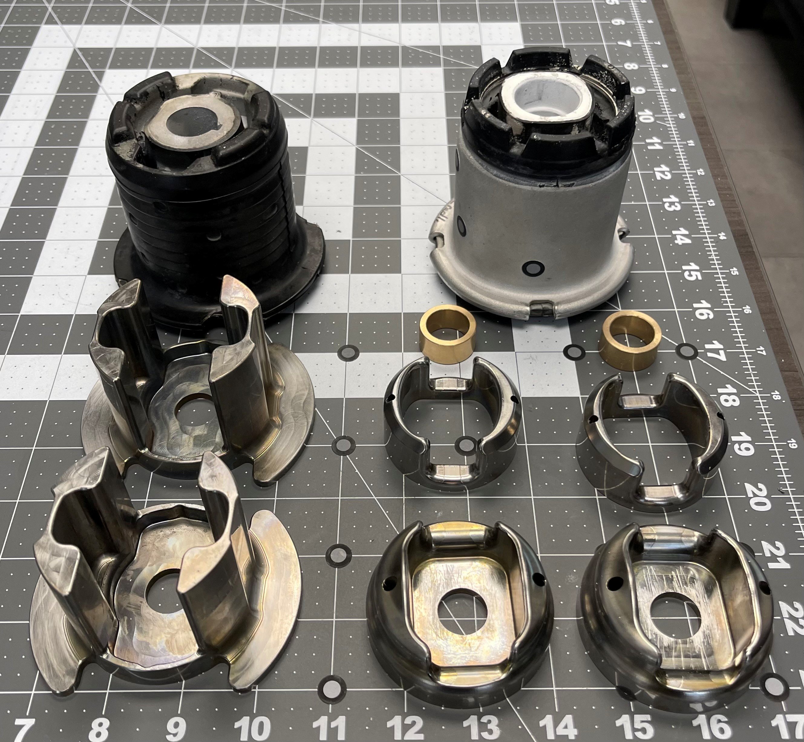

Rear Craddle Bushings
The rear bushings on the Blackwing are the same rear bushing in the 2.0 and 3.0 models as well. They are not stiffened up for performance and I feel that some of the rear squishy feeling could be attributed to that. In all my previous sports cars the rear end always benefited from adding some rigidity to the rear bushings, wither it be inserts or swapping to polyurethane. I feel in our cars the swap that Cadillac made in the Precision Package to stiffer rubber bushings and not rigid aluminum like the ZL1 1LE is ideal to maintain drive ability , but no options as of yet exist. And even once the parts are released the work to swap out the bushings is substantial. Right now I can looking into comparing the Camaro6 rear craddle bushings to the CT5 and seeing it there is any crossover so that lock out kits from that would possibly be used. If so, I would post options in here as well.
Update : There's a guy currently working on cradle bushing inserts for the CT5 , he has already made a solution for the CTS-V V3.
