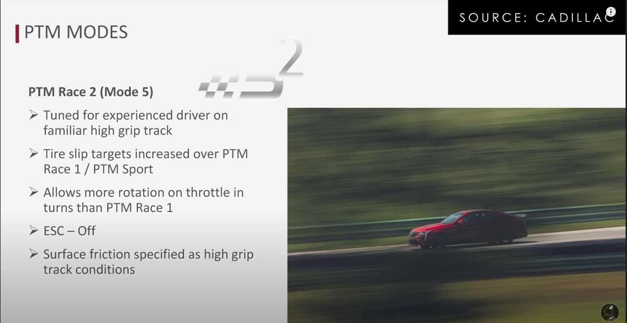

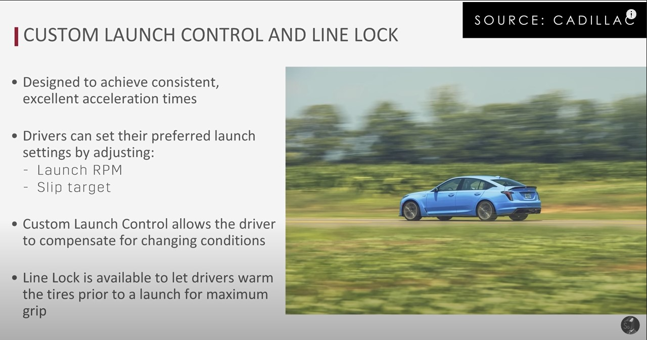

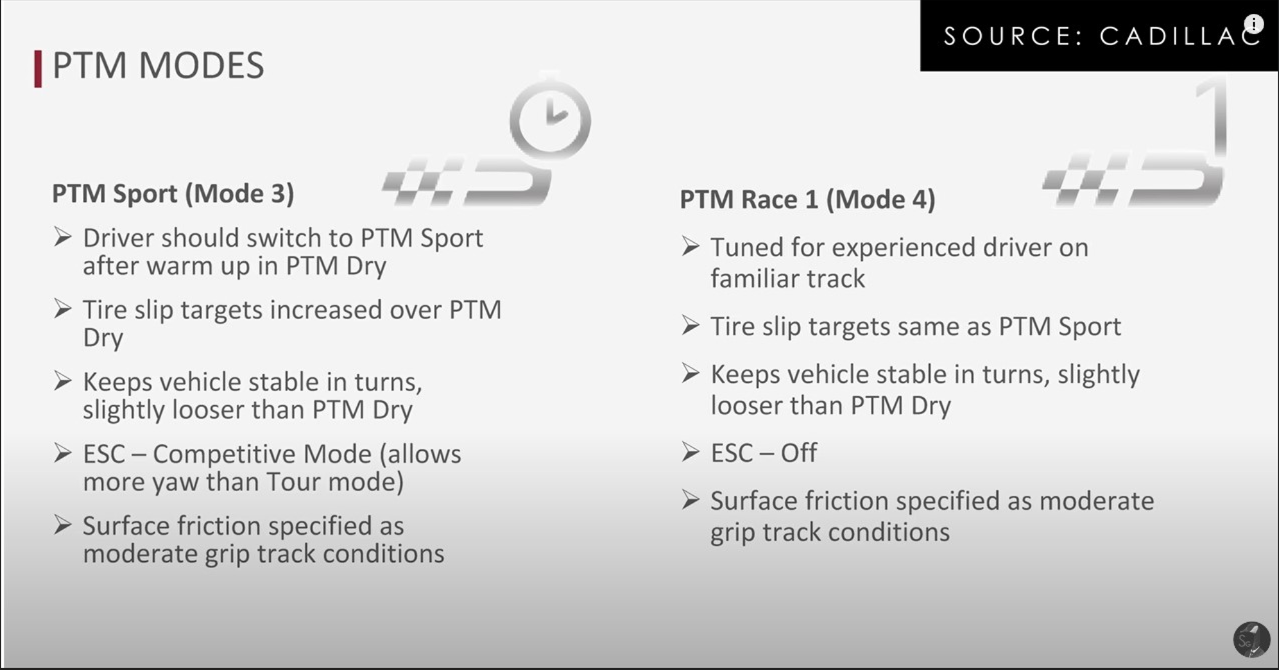

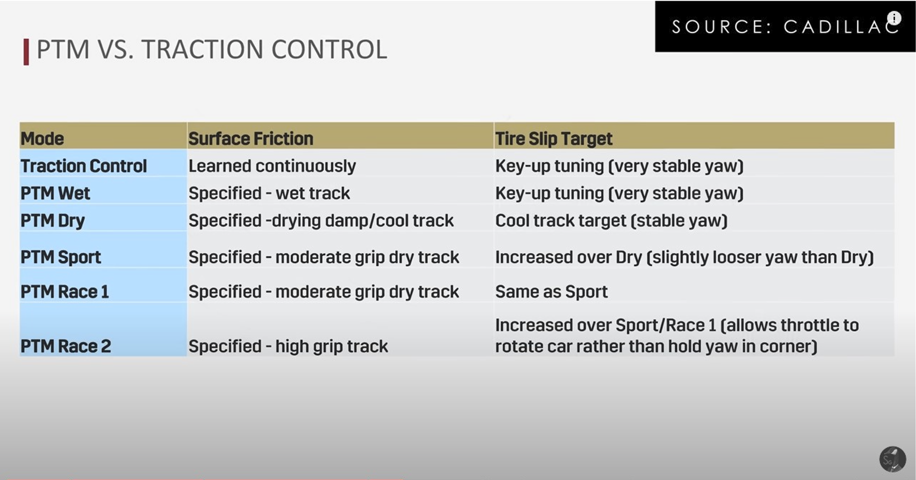

These are some slides from a Spring Mountain presentation regarding PTM wet & dry:
Do you have access to all of those Spring Mountain slides?
Nice, have to try to learn and remember these so I can be ready for Spring Mountain in April.

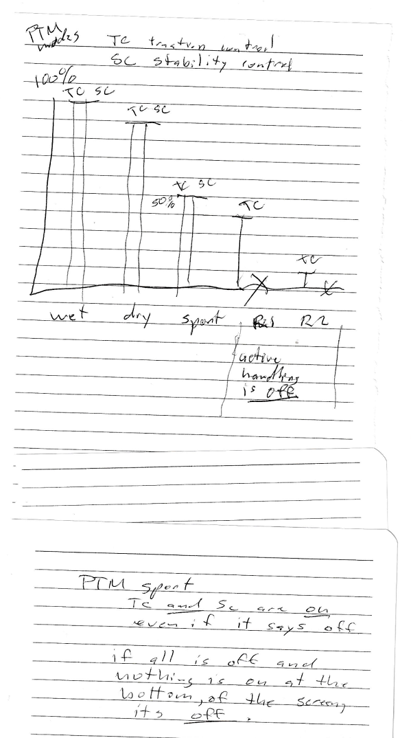

These are some handwritten notes from Spring Mountain, additional details of PTM:
Bottom line for the above is there is always some level of TC. I do think it can be turned off completely, but you have to take extra steps to do it. Otherwise, it's always there regardless of what it says.
