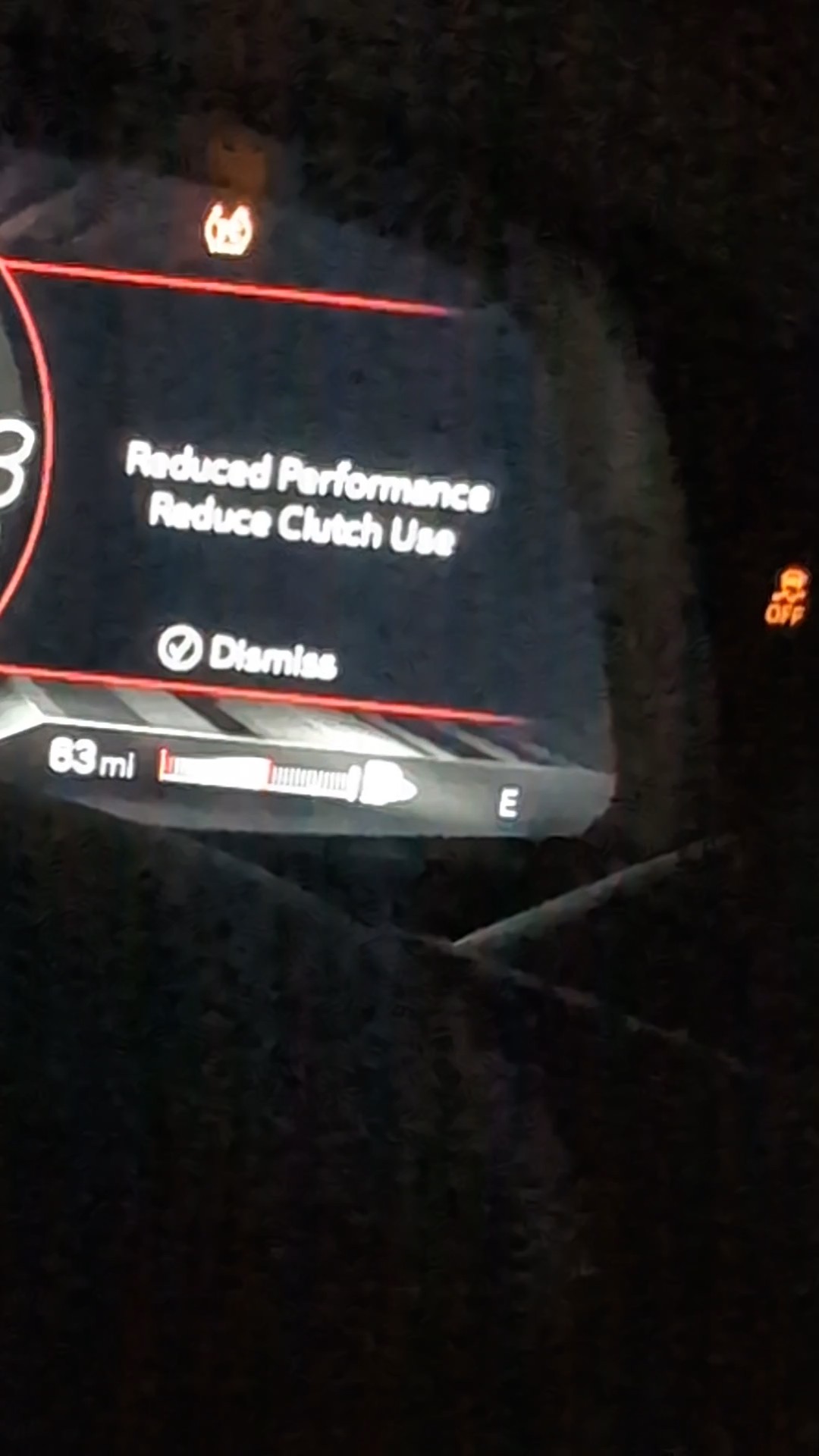

Does this indicate a bad clutch or a bad sensor?
Reduced Performance Reduce Clutch Use
This is one of them tricky ones.. your pushing a lot of powa. Have you tried data logging, perhaps in 4th (I think that’s our 1:1 gear), log both engine rpm and the trans output shaft speed? What’s the delta? It would help narrow in on if the output sensor is toast, or if you're slipping at a certain RPM which would be seen when monitoring the delta between both engine rpm and output shaft rpm.
Also, I recall reading some issues with the Camaro groups with guys who were pushing some good power, having a similar issue when they got on it. I believe this was the TSB for it https://static.nhtsa.gov/odi/tsbs/2020/MC-10180313-9999.pdf came down to a reluctor wheel slip due to a under torqued flange nut, replaced with a new nut/torqued and resolved the issue for many.
Either way, could be clutch slip with the power you're pushing but I’d start with a data logging in the 1:1 gear to confirm where/when/if slip is occurring and work back from there.
I played around with it this morning, the clutch is definitely slipping under load, time to replace. Going to go with an RPS triple disc.
