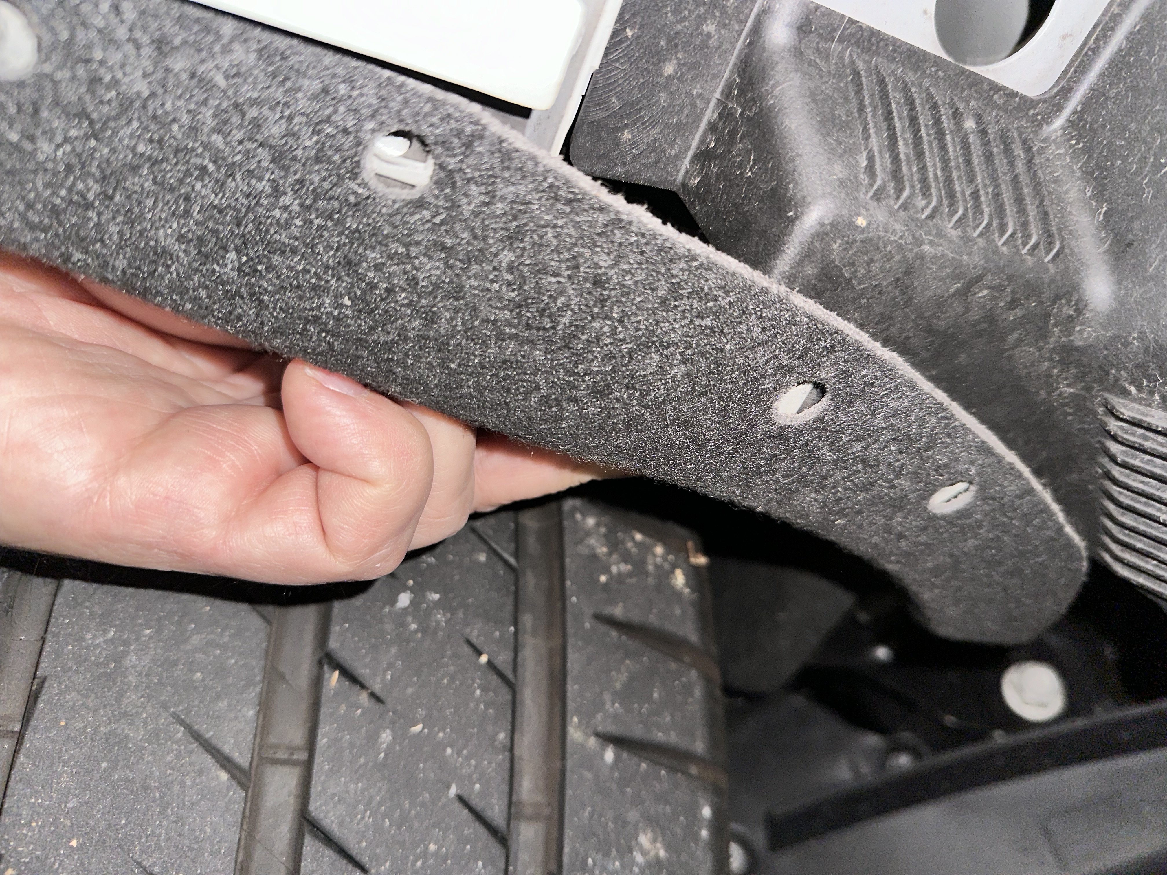

While working on my car, I noticed both rear wheel liners (bottom front) were very easy to push back towards the tire. Upon further inspection, there are 4 holes with nuts, but no screws and no marks showing previous screws. I can’t understand why each bottom is not secured. I want to put screws to secure both sides and can’t see any issues if I do. There is a plastic push plug inside the wheel liner roughly 5” up.
Can someone please check to see if this is normal from the factory on a 5BW?
Not sure if it matters, but my car is a 2022 with iron brakes and originally without any carbon packages (CF1 & CF2).

Mine were also missing. The non BWs I think are supposed to come with a wind deflector here.
My fender actually would pull away at high speeds and rub against the wheel to the point it wore a hole in the fender. I got some fasteners from amazon and secured these and the problem went away.
Thanks for the replies. I had 6 of the GM style screws with washers (same as used for the front splitter and other areas) and put 3 on each side. I noticed the plastic cover it screws into can flap and hit the body as I could see a rub mark and make a rattle. After I added the screws it secured the wheel line, plastic cover and rocker all together nice and tight.

Well then, maybe they figured out on 24’s the screws were needed. After I put the screws, everything is nice and secured.

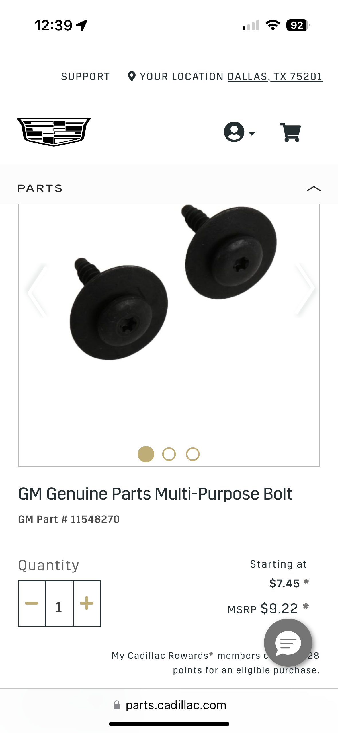

I did buy mine from Amazon and they were significantly cheaper than the dealer, so I have extras. Better to have them screwed in, at high speed it may rub against the tire.

The screen shot I posted to share is how I found the part number and then was able to see they were the same in my deflector package. Yeah, no way to over pay the dealer as I found the same on Amazon for $10 for a 20 pack as well. I bought to have some around in case I find more missing, lol.

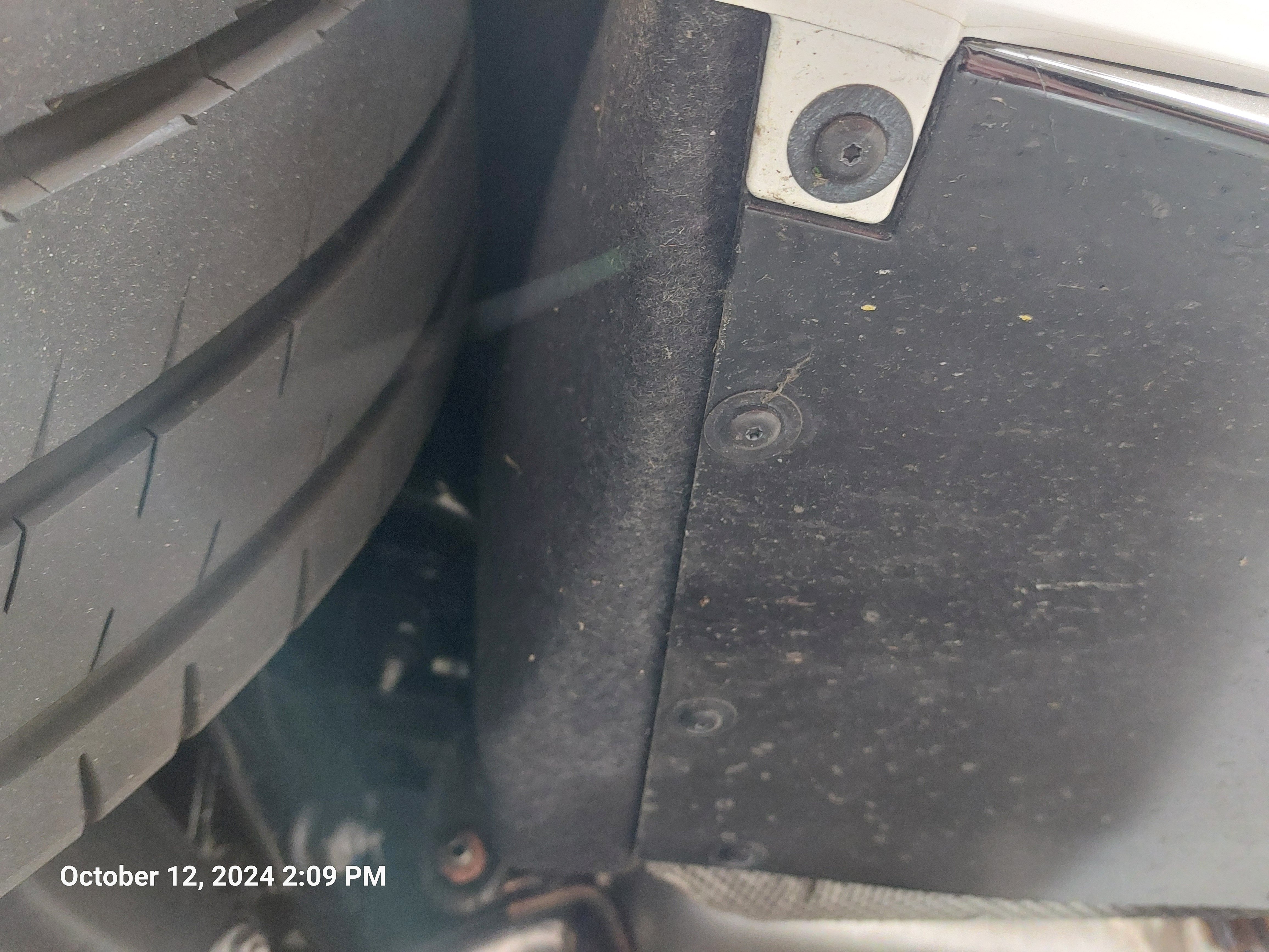

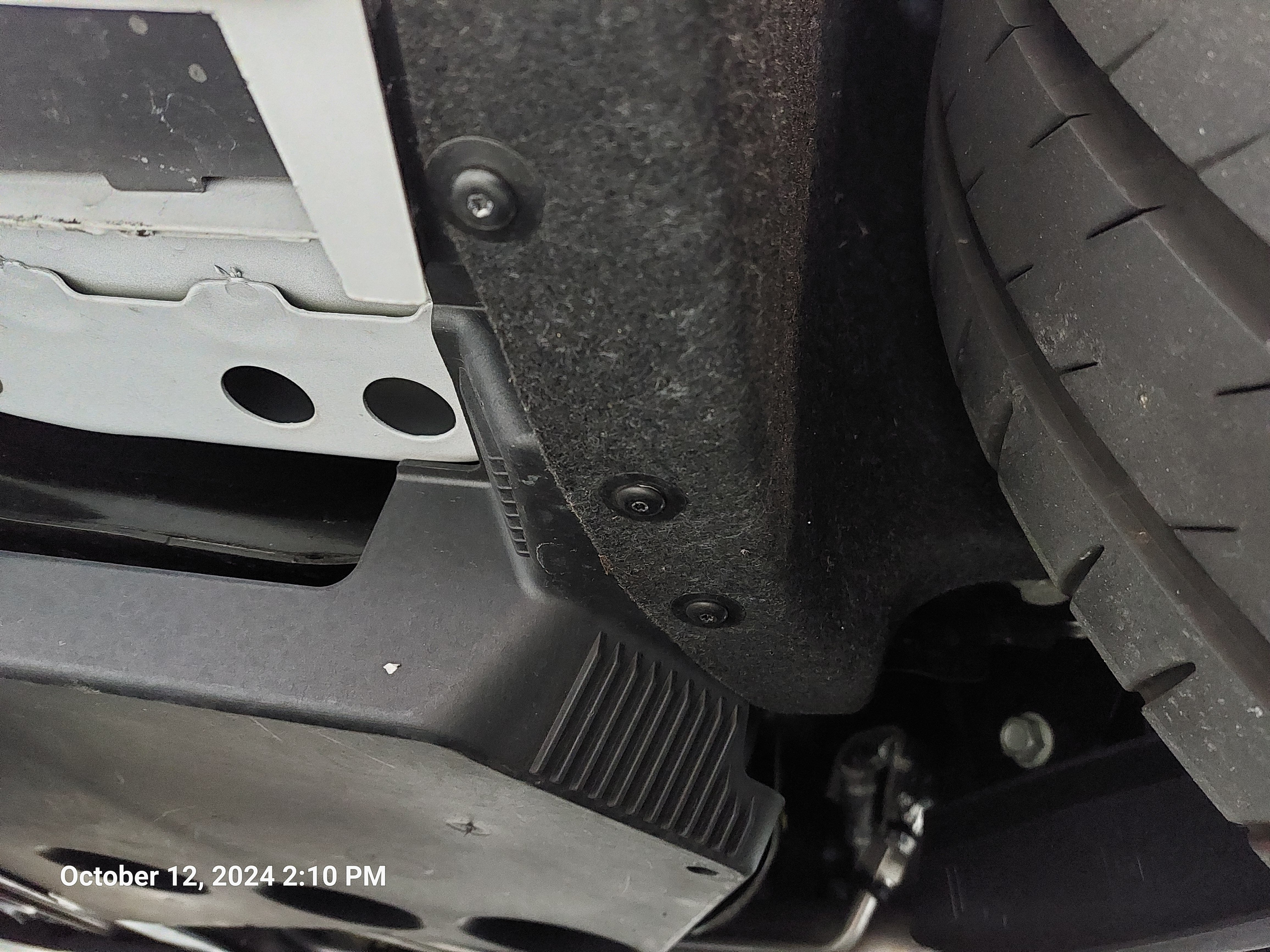

@KatyTxCT5V
Late to the party..................but, here's a picture of my left rear.
2024 CT5-V Blackwing. Build date 11/23
Front of rear tire:
Behind rear tire:
