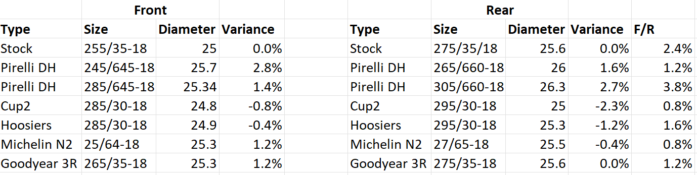

I was looking at tire choices and found something interesting, Goodyear Supercar3R are available in 265/275 sizes. These would be even better than any 200TW tire in 275/295 whatever.
This would reduce the OEM 7mm rake to 3.5mm, I don't think this would screw up the aero since just weight in the car could have more effect than that and it's still better than removing it completely with a square setup.

I really like the 3R, so that looks like a great option. There are also a number of ways to get some solid discounts on them which makes them cheap to run (e.g. USAA). I'm not so much worried about the rake and aero, rather it's the issues that the taller fronts will throw off the wheel speed sensors.
The car will think the fronts are travelling slower than the rears, that means under braking it might put more bias to the rear, or PTM will intervene sooner thinking there is wheelspin. Realistically, I doubt the car is that sensitive, or that us mere mortals will notice the difference.

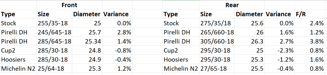

Here is an updated chart:
