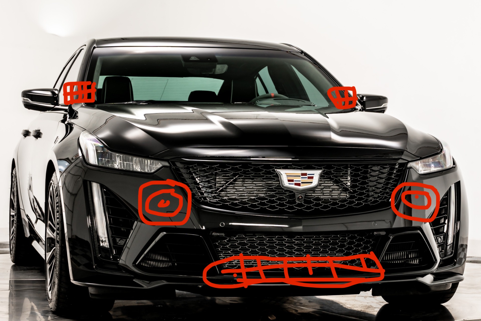

I'm planning on auxiliary lights. Light bar and pods. Haven't gotten around to the install yet.

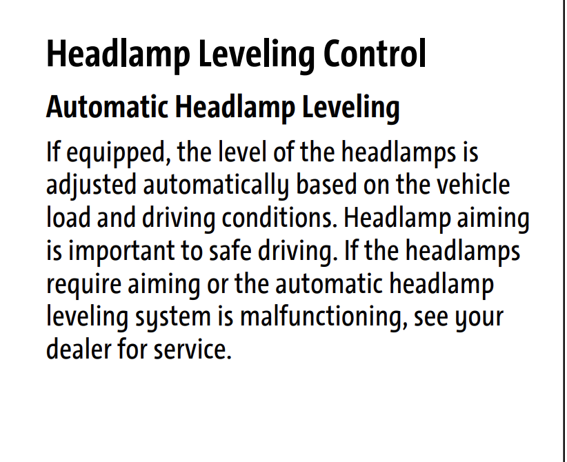

I would take it to the dealer and have them check it out - perhaps the low beam LED's are not self adjusting correctly.
Confirmed from the owners manual - the 25's do have auto leveling. Get your dealer to fix it.

MY24 here also in the PNW. Same complaint especially in the rain. Unrelated, no rear window wiper is also a disappointment.
I'd be interested in pics of that install. KC's on the roof?
Here’s the concept. I have the lights. No hurry to install w/ race season coming up.
