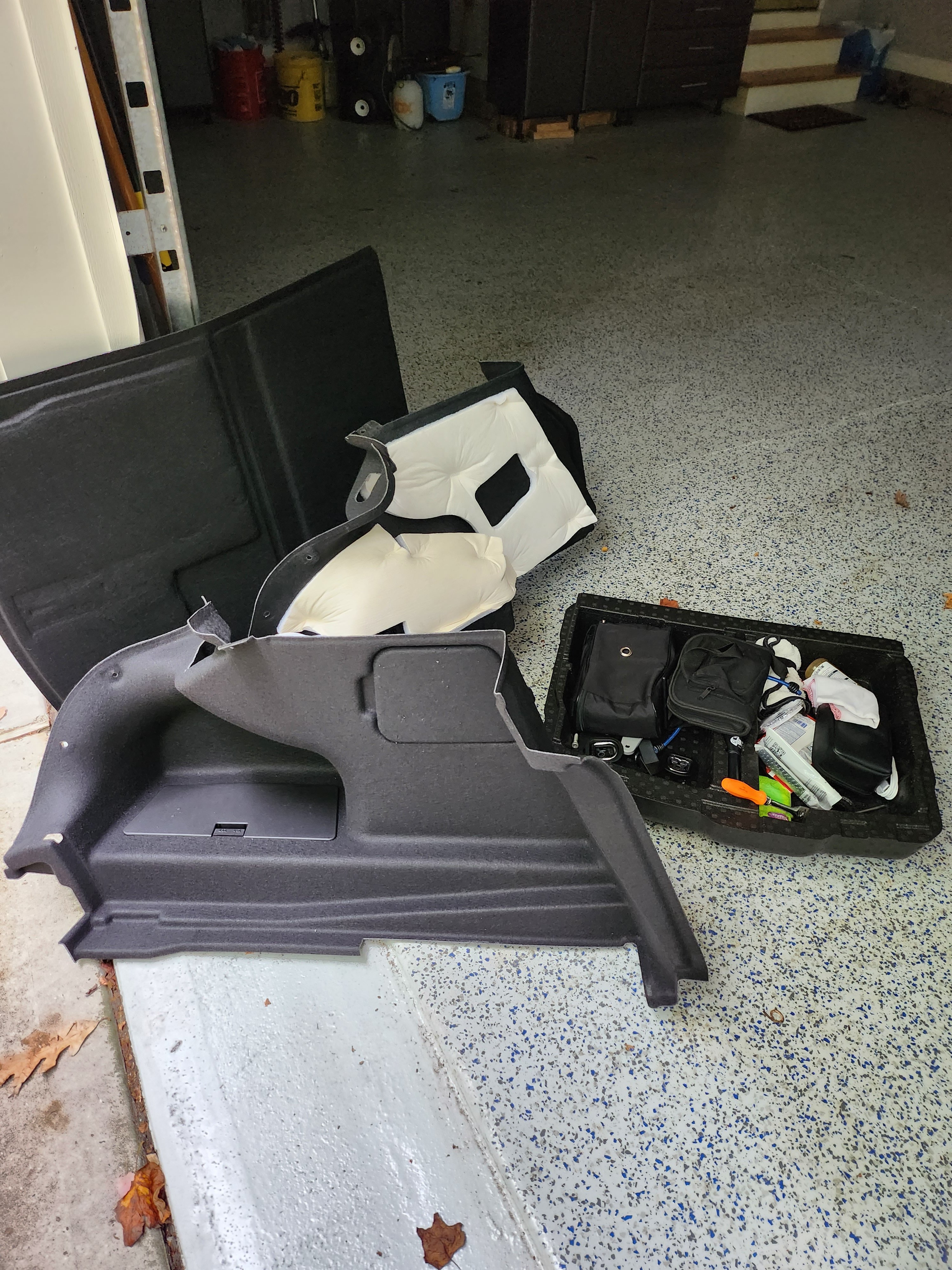

One of the few complaints I have about this car is the amount of road noise. To save weight (I presume) Caddy has left off sound insulation in large portions of the car, and it seems that most of the noise comes from those huge rear tires, so since I had some leftover Dynamat from another project, and it was perfect work-on-the-car weather Sunday afternoon, I went for it.

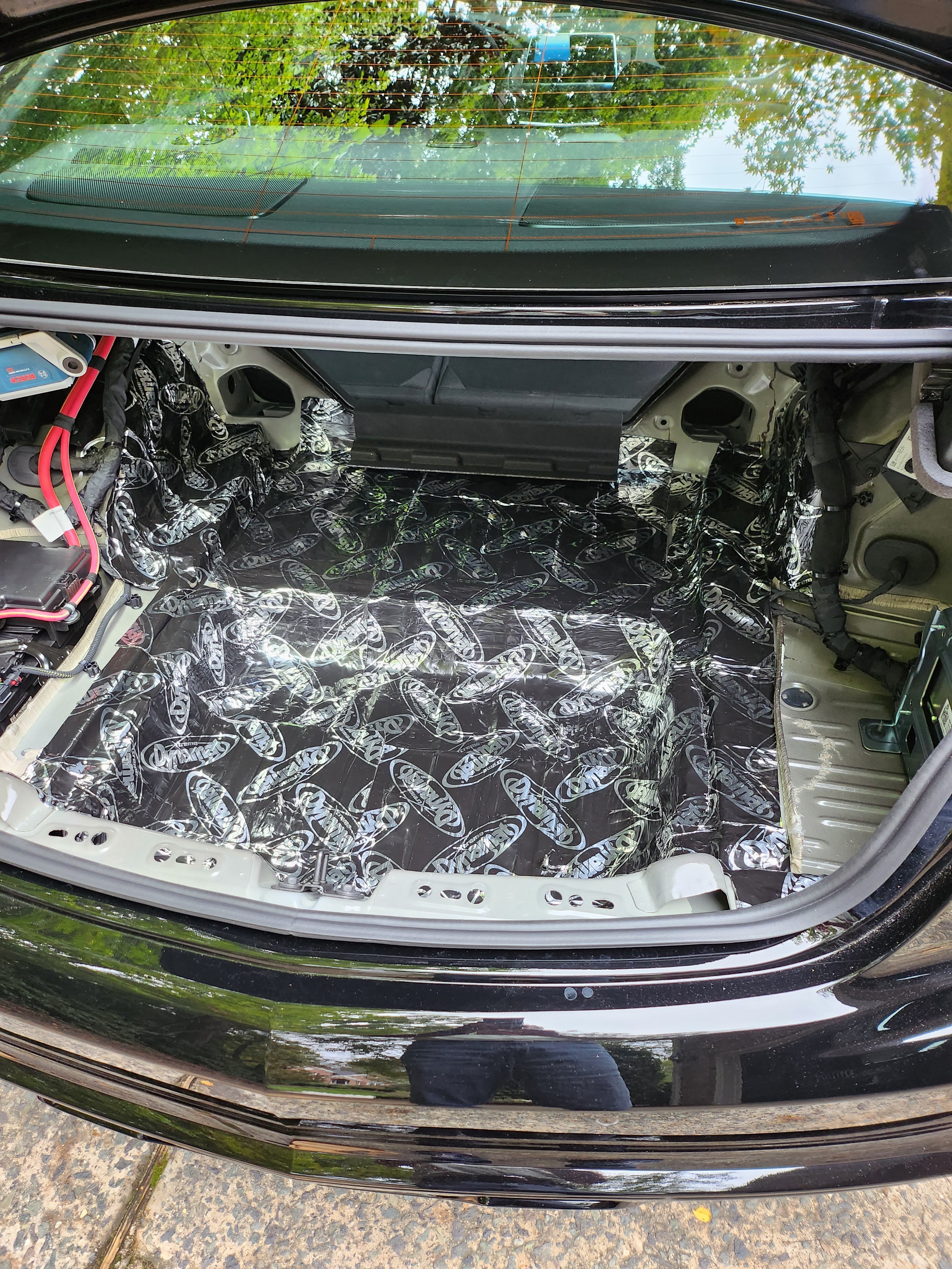

Below are pictures of the removed trunk trim and how it looked when I finished. I did, as some will undoubtedly want to mention, a half-assed job. I did not feel like removing the computers, amplifiers, battery, etc. to cover everything like I should have, but even getting just the "easy" areas can still make a difference. Part of what Dynamat does is reduce the frequency of the metal so that it resonates less, reducing the boominess and higher frequencies. Or maybe lower frequencies. Who knows? Dynamat is also a real PITA to deal with, as it is stiff and very very sticky, so you can't easily slide it into tight spaces.
I did not do a before and after sound measurement because a) traffic was bad Sunday and I didn't feel like it and b) the last time I did something like this, it was a negligible measured difference. It does work though, as I could tell a bit of a difference driving into work. It's not so much that it's quieter, but the character of the noise has changed. Also I noticed that the wind noise from the driver's door seems to have increased in volume, which tells me that overall it's a bit quieter.
Would I do it again? Well, if I had to buy the Dynamat and do it, probably not. But since I had leftover and it wasn't being used for anything else, then sure, it was worth it (being basically free).
Dynamat isn't fun to install. Looks good though.

It looks like you did a really nice job, professional looking IMO. The front tires have foam inside, too bad we can't track down more of that stuff for the rear tires which would help as well.
I know they sell spray insulation foam specifically made for sound deadening which could work well in hard to reach areas. It could be sprayed on the outside between the tire lining on the metal structures.
Did you consider that or have ever worked with it?
I get that, it's a trade-off when adding insulation to make the car feel/sound like an old Brougham rather than a 21st century high performance car.
I agree that the road surface makes a huge impact on the noise, as do the tires. These high traction (and I do love their performance) Michelin PS4S tires are a big part of the issue I believe. I'll likely go with some nice granny all-seasons when these wear down. Unfortunately, a large portion of my commute (this car is my DD) is on concrete highways, the remaining portion is on a highway under construction/expansion, and I suspect that most of the new surfaces (if they ever finish it...) will also be concrete. Around here (NC) most highways are concrete, and then when they get really old they start laying asphalt on top of them.
As for the foam... no, I have not tried it nor do I think I want to. My primary concern is getting any of that stuff on or in the various computers and wiring back there. The dynamat is going to get soft and gooey when hot, but it's not going to go liquid and run into stuff. The foam won't either - once it's dried, but during installation it can be messy and it expands enormously. So a small mistake could be catastrophic.
