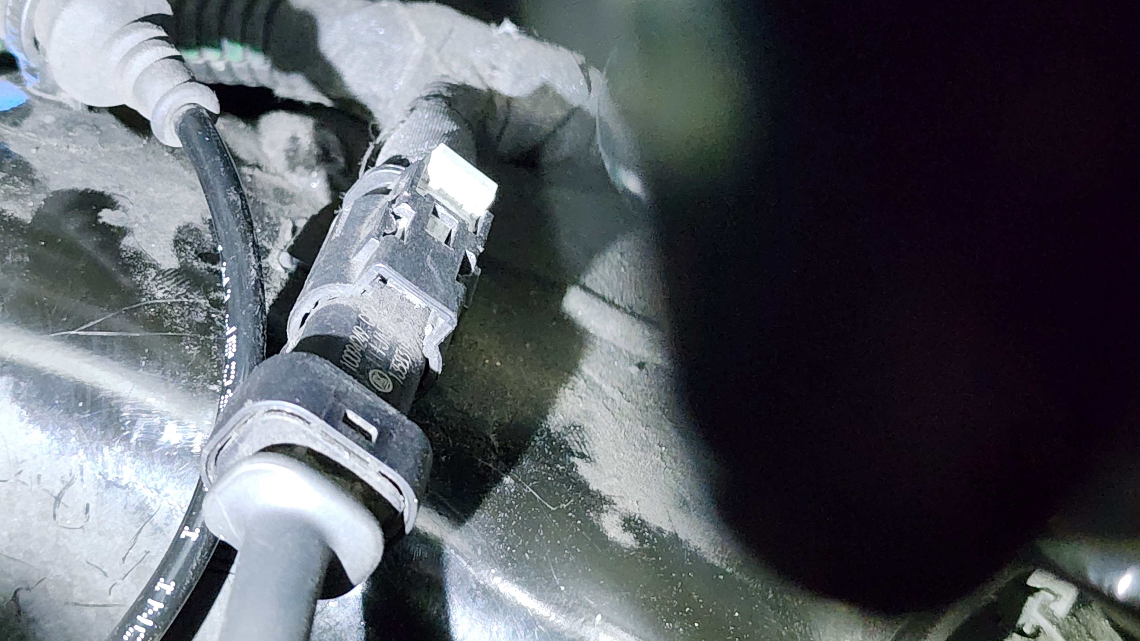

This thing is a pain in the ass......or is it? Help a brother out. How do you unhook this easily?
This is the right rear wire for brake wear sensor. The white clip seems to click/release and slide back, which seems like it would expose and release the little fin keeping it together, but I can't get it apart.
Anyone done this already?

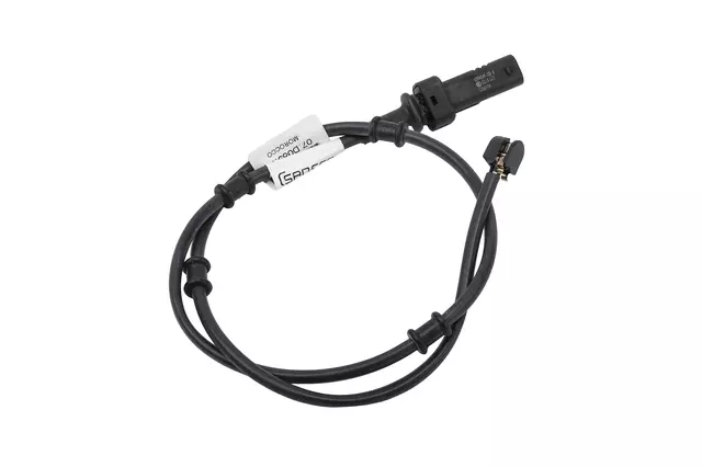

This image shows the top of the part:
These connectors are the bane of my existence! I've done a lot of brake jobs on my cars and a friend's lately so I'd don't remember this one specifically but I think you depress that little square and pull/push that tab out at the same time for this one. I really wish manufacturers would standardize these connectors.
If you haven’t already worn down the old sensor, you might be able to pop it off the old pad. Then either pop it on the new pad or zip tie it out of the way.
What poor-sha said. I was able to get the front sensors off and into the new pads with no drama.
